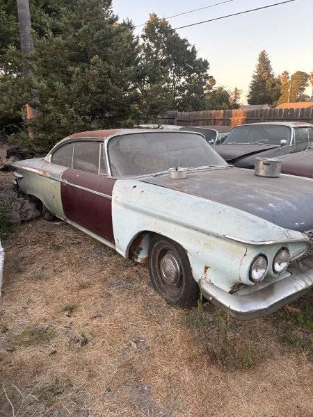

I have a OEM 413 max wedge heads,intake exhaust manifolds.
I have what I believe is the 3 speed manual from from 62 MW car.
A 745 if I’m correct?
I have several 413 motors to choose from.
61,62 and 64 imperial motors
What should I know about putting this top end on a standard 61-64 413?
I know about 8 bolt on 61 motor.
I would want to use 61 motor as it’s going into a 61 Belvedere.
I’m told I can change crankshaft to match post 61.
My main question is would I be OK to use a original MW top end on a standard passenger car motor?
