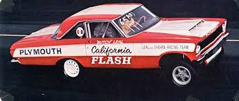

I have seen a few pictures of the guys that raced the max wedges and the A990 cars which had 15" rims on them.
I was wondering what these rims came off of back then.
Thanks, I will call Kramer.

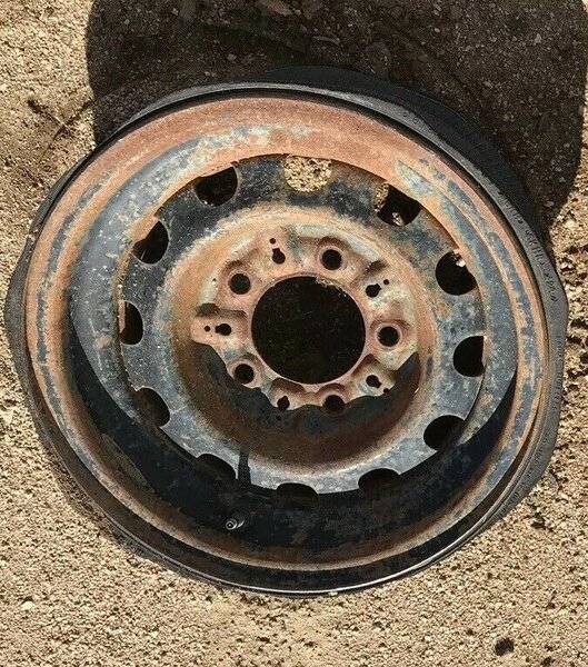

A100 vans
And Imperial rims

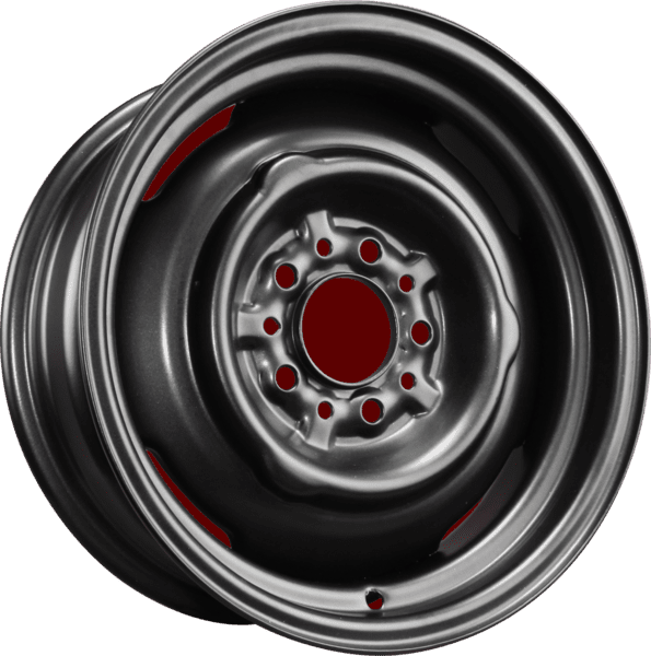

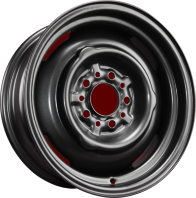

Would just have to find someone that could attach the centers to nice 15" rims with the width I choose for the rear wheels. I would like to go with 8" width, which I know is not for period correct cars back then.

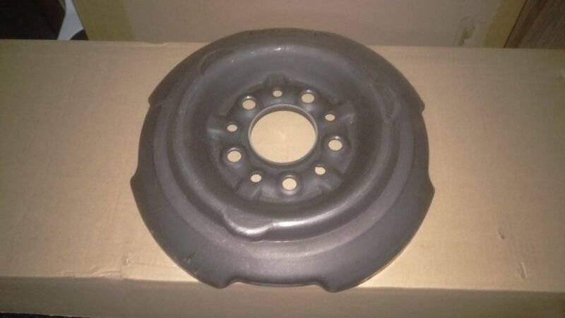

The centers are 13.25 inches , which is the size of a standard 15 inch Mopar steel wheel band. Not the size of the original 15 inch Mopar steel wheel of that time period , which was 12.75 inches. When I had these made , I had the size increased to fit into a standard Mopar steel wheel band. A side benefit , that has been brought up by my customers , they clear the Mopar single piston disc brakes , that some people are using on their cars.
As far as someone to build the wheels , I know of 3 places so far , two in CA and one in WI that I have worked with to build out the wheels.

The bolt pattern on Imperial’s in that time frame were 5 or 5-1/2” so they wouldn’t fit the standard B-body rear end.
Yep my bad,
I was forgetting, at that time, the Dana's were borrowed from Ford f-100's 5 on 5.5

Frank,
Just ordered a set of your centers (in wheels of course) for my 65 Belvedere I. I ordered 15 x 7 4.5" backspace. Had them powder coated gloss black. I will post a pic or two once they are on the car. Out of curiosity it looks like you make up the 1/2" around that first lip on the band which makes it a 1/4 lower? I ordered for the 9 3/4 inside diameter center caps.

Not exactly sure where you are referring to , that I made up the 1/2 inch ( 1/4 on each side ). But if you compare an original and my center , the 1/4 inch ( all the way around ) is just past the nubs for the dogdish cap. The cap area had to stay the same , the rest of it can be adjusted in CAD. Oh no , the secret is out of the bag.
