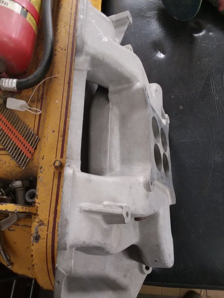

Looking for a picture of a set of max wedge intake gaskets. Does it still use the bathtub style intake like the standard big blocks? Also does it run the standard style bar type 3 bolt hold downs on the end? Buddy has one someone right stuffed down and I need pics of what was originally used on a 426 max wedge style intake non Hemi. Thanks in advance!

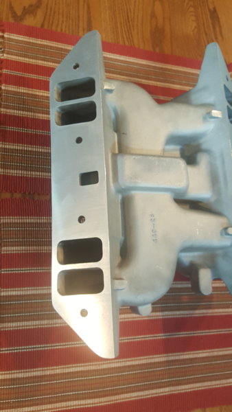

I was thinking the same but then I see pictures like this in jegs. Was curious if the bottom of the intake sealed like a small block or is it the same as normal B/RB gaskets?

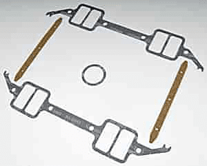

So kinda like the small block does, a good bead of silicone at the ends and corners and then paper on the ports?
Yep
gaskets for the heads and the china wall and the round one is for distributer

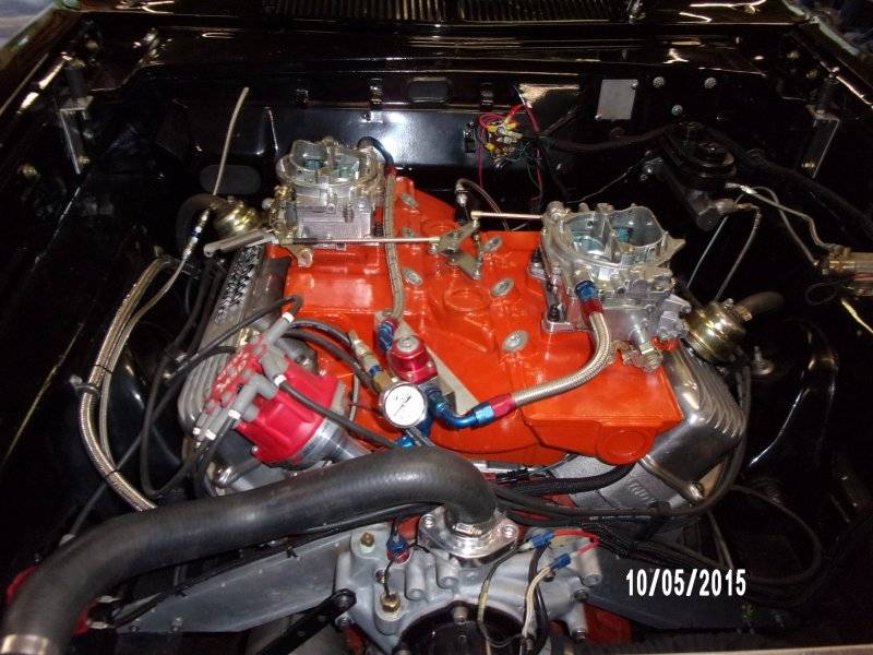

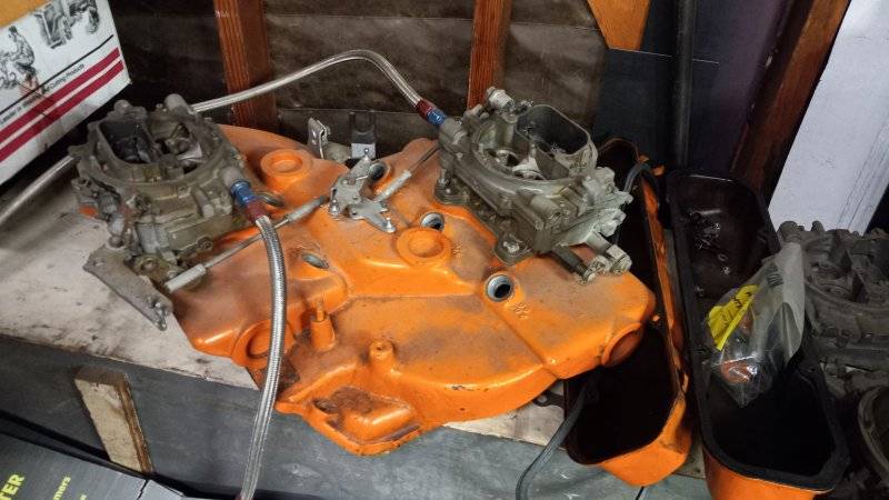

Were all max wedge intakes two 4 barrel? I thought the max wedge heads in some applications had a single 4 barrel?
It is possible in todays world to have a single carb on max wedge heads with the manifolds available.
As for original "Max Wedge" they were 2 carbs on a cross ram intake.
The term Max Wedge" is sometimes used incorrectly these days. IMO

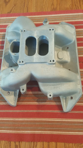

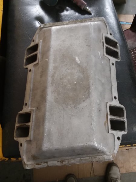

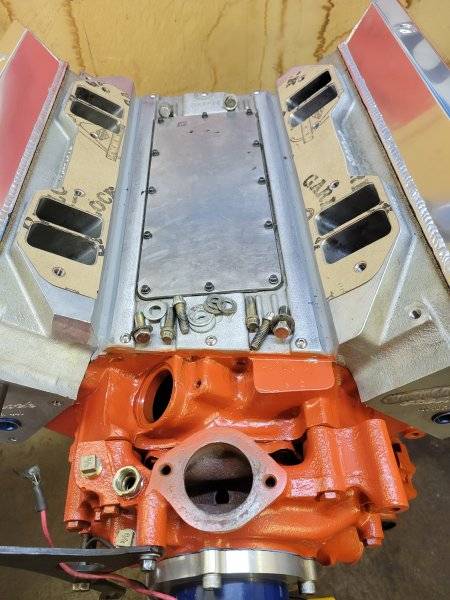

There is no bathtub pan gasket for max wedges.
Hughes Engines Inc. has the Max Wedge gasket kits. I used them on my 440/906 ported heads with
their valley pan and a single 4BBL Indy intake. The gaskets come in two different thicknesses. You
choose which ones. They seal really well. I don't think any Max Wedge came out of the factory with-
out a Crossram.

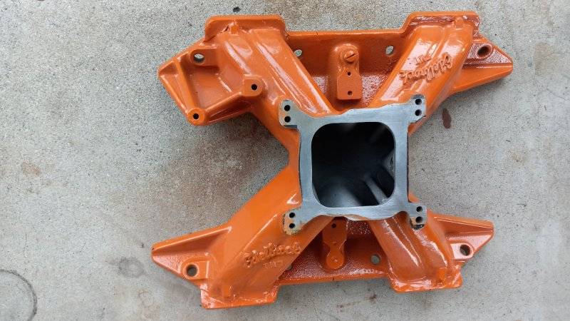

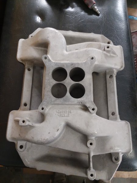

There were (VERY rare, and not very good) Nascar single four manifolds for max heads. Just like the two fours crossram, the had a cast-in valley cover that sealed the valley and China wall. Think 337 manifold, only not near as good.
I have used a single 4bbl TM7 welded up to maxwedge port size. Sealing the valley was a nightmare, with the iron heads. Would have been much easier with aluminum head that don't have the cutouts between ports.
After several failures of homemade valley pans, the final best solution turned out to be..... the stock bathtub seal, cut to ribbons, top of the port removed, and dual home-cut from gasket material side gaskets, set of four, one on each side of the cut up valley pan.

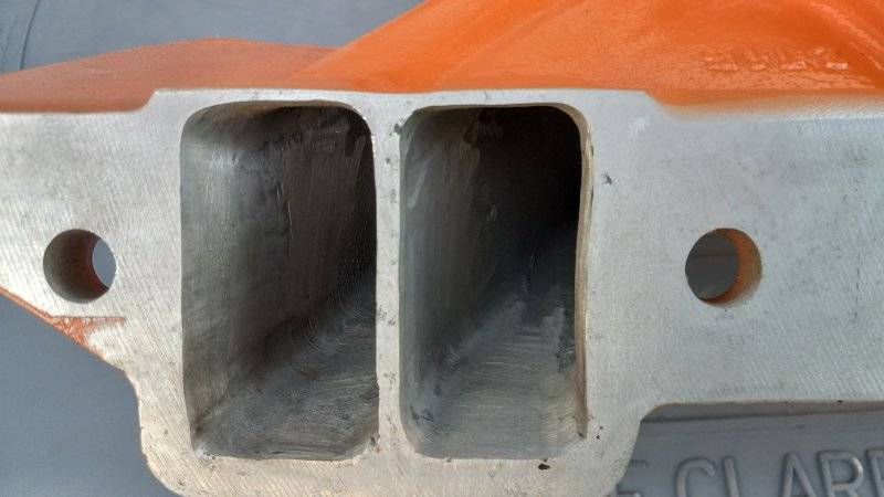

The port pic is of the tm7, upside down . The thin area is the bottom of the port, the thick area at the top (bottom of pic) is the added-on welded chunk.
