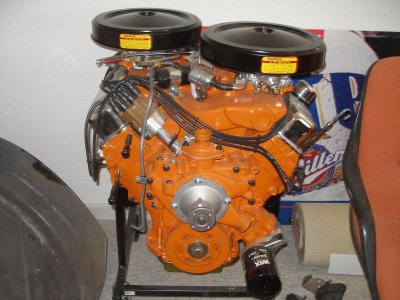

This is my 440 built as a 426 Max Wedge
A&A transmission Aluminum manifold set-up
Built by Mr Dale Reed, Baldwin Park, CA (Max Wedge expert)
This engine is 600HP
Very nice! In the HOT ROD mag article they bought and applied "Ramcharger 426" stickers to the valve covers after the build. They used a '77 440 from a motorhome. Reminds me of IQ52's thread about building the low compression 440.. Also it is very correct that you wont be finding any original MAX Wedge stuff unless your lucky or rich as Superstockers and restorers are using them all up. My new friend Bruce has some max wedge stuff but prying out of his old gnarly hands is another matter!!lol.

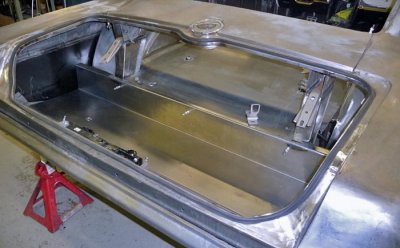

On another note, i'm close to finishing the now flat trunk floor in my '67. Next up is the gas filler being removed and the door sewed shut. Then a Charger flip top and surrounding sheet metal will be grafted in on the forward trunk lip and the trunk curved around that so the seal will flow around it all like it was stock to begin with..
Like on this 65 Impala..

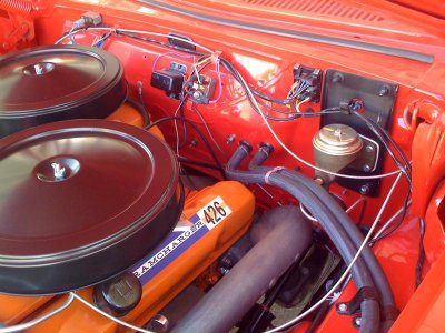

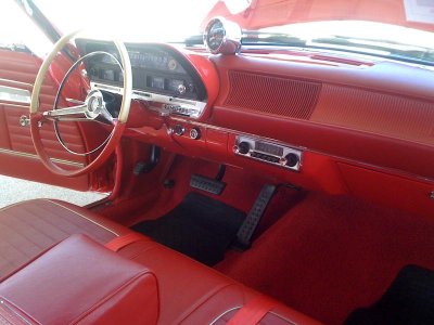

These Max Wedge cars were NOT for the Street!
They were (and are) Race engines...
NASTY...temperamental, not user friendly...
He goes to Spring Fling, Van Nuys every year. And fall fling to.
See pics below:

I agree that they are beasts when u have a real Max Wedge. I am more looking for the look and a bit of HP and torque. Really just a mild warm up from stock 440. I like how the MW looks and i'm thinking about how I want my engine bay to look when I get there. Prior planning...
Build it... Enjoy

A REAL Max Wedge is a nasty beast...
My Bud owns one here 45 miles from me in So Cal.
When he starts it up, it takes him 30 minutes to "warm it up" so he can drive it.
THIS IS NOT A "JOKE" NOR embellishment, He said it is very NASTY.
He's about 70 now, he is NOT into making up stories for fun.
See pics below:
