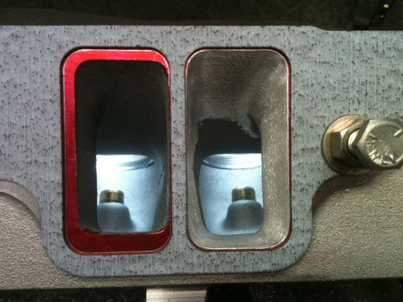

I have 452 heads with the roof enlarged out to where they are .005" taller than an Indy 440-2 MW intake port intake. Which is still a shorter opening than a true MW port.
There is physically not enough material in any non MW head to port them out to true MW height or width.
Somewhere on here or FABO I have several photos and the measurements posted.
