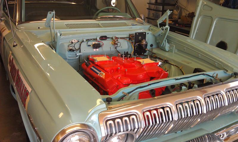

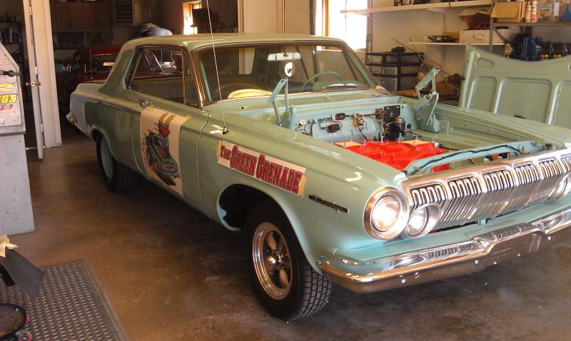

OK, got the intake on and took your good advise. I did a test fit and using a single paper type gasket lined up really well, so I used copper coat on both sides of the intake gasket and ultra black silicone on the ends. I used a small block and tackle to lower the intake carefully andused one intake manifold extra long stud to guide the manifold into place. It fell in place no sweat. Thanx a ton for the help.
