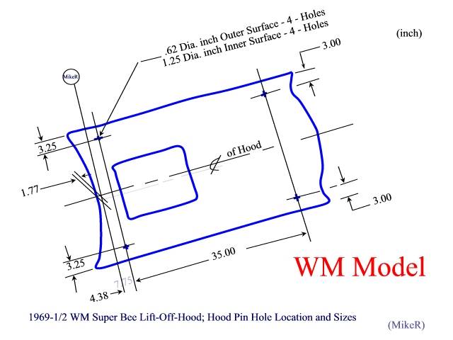

Does anyone have the measurements n photos on where to mount the studs for the hood,thanks n advance
Roadrunner or bee?
A little blurry I got it off this site. You can search it.
A12 has four pedestals to mount the hood pins. If you don't have the pedestals, the proper hole locations won't do you any good, cause there won't be anything there to mount the pins to.
Tomorrow I’m looking at a Super Bee Six Pack hood, and are these measurements the same for a Bee?
Disregard, found the Bee hood measurements.
