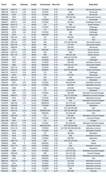

Here is the factory drive shaft specs for 69-76, all car models, engines, transmissions, differentials.
If everything is in the factory location these numbers should be enough. There is more than one reason that the input of the shaft goes in and out during suspension travel. They have to have a design spec to publish but the cars were never built to "blue print" specs
