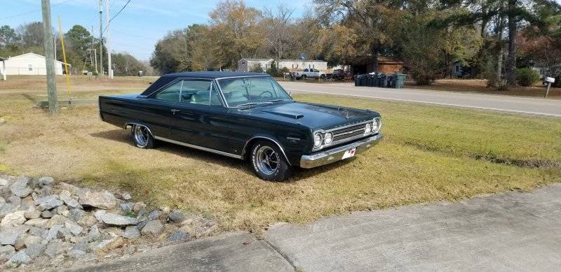

The original fuel pump on this GTX failed about 3 years ago.
I found an original carter and replaced it. I think 55 years was a great run on that fuel pump.

The original fuel pump on this GTX failed about 3 years ago. View attachment 1854015
The original on my GTX went 35 years and was replaced with NOS. If that fails, I’ll get the original rebuilt.
