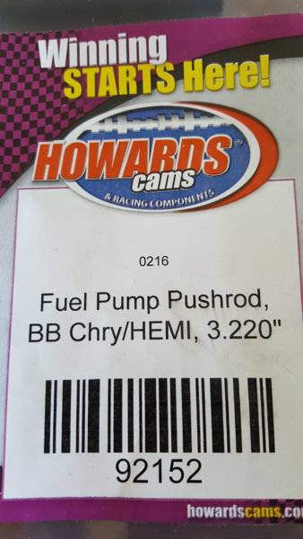

If you need a new pushrod, go with this one. If it's a little snug just sand it with some real fine emory. The one I used went right in with no problem.
https://www.summitracing.com/parts/hrs-92152

If there is too much wear, make sure to get NOS or a good brand (Howards as mentioned) replacement!
