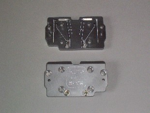

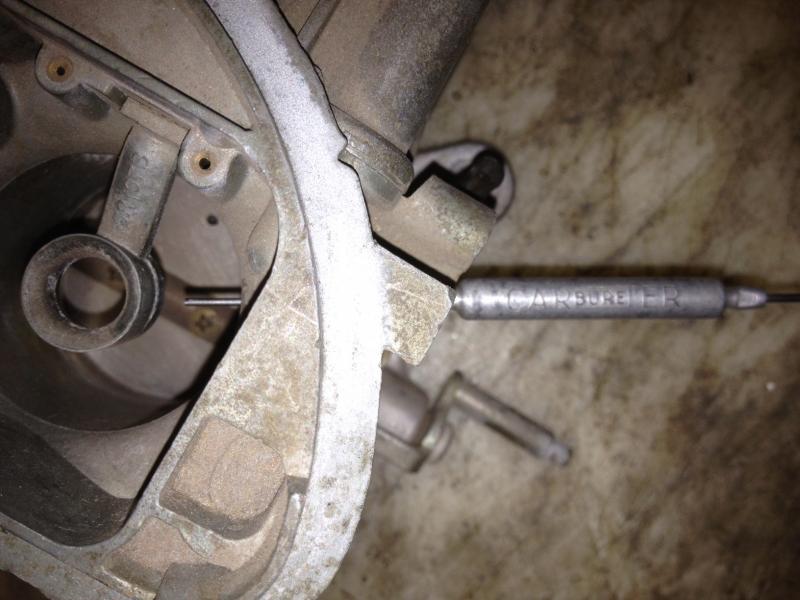

OK, here is the second attempt at the photo posting. Note the pin gauge (please ignore the fact that I'm using an old Carter gauge on a Holley) but this shows the air bleed passage that can vary in size. As I said, even the 4 BBL's have it and if plugged you will have some instantaneous secondary action!

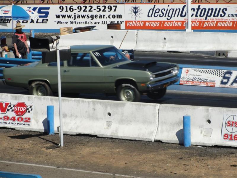

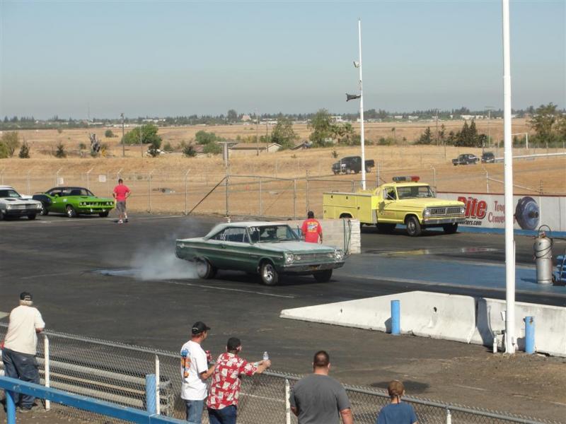

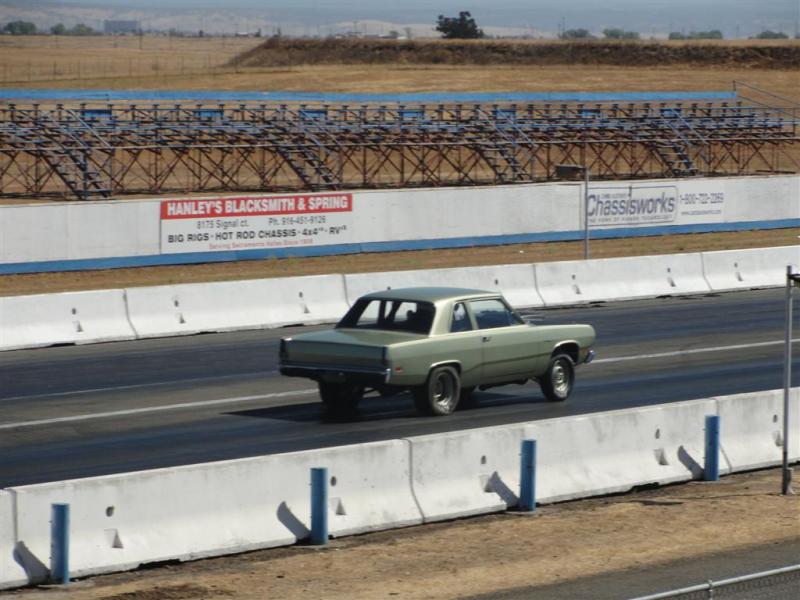

Here are some pics from the event. A fridge in the pits!? Now that's cool! Ahh, you knew that was coming.
The green Valiant was a low 11 second car I think and one of our favorites from the day. Running a big block and an aftermarket slick shifted 4 spd with a Long shifter.

Meeps; Like you said when we talked on the phone, damn there's nobody there... Belvedere looks great in the water box...
Yeah, I was pissed! I darn near had the track to myself but car ran like $hit so I parked it. Still, like someone said, a bad day at the track is still a pretty good day overall. Got to see some great cars and talk to some great folks.

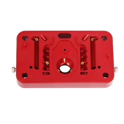

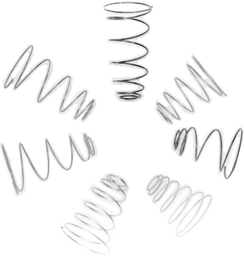

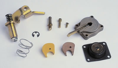

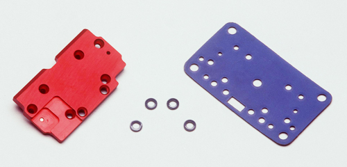

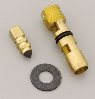

Maybe try Quickfuel too, they have some great stuff for six-packs/6bbls Good luck meeps & keep us posted.... Holley, Quickfuel & Pro-Maxx in mine, some of the items I have below... I say fully adjustable secondaries/outboards is a must...

  • Quickfuel Billet Merering Plates adjutable replaceable jets for Vacuum Secondary.jpg
