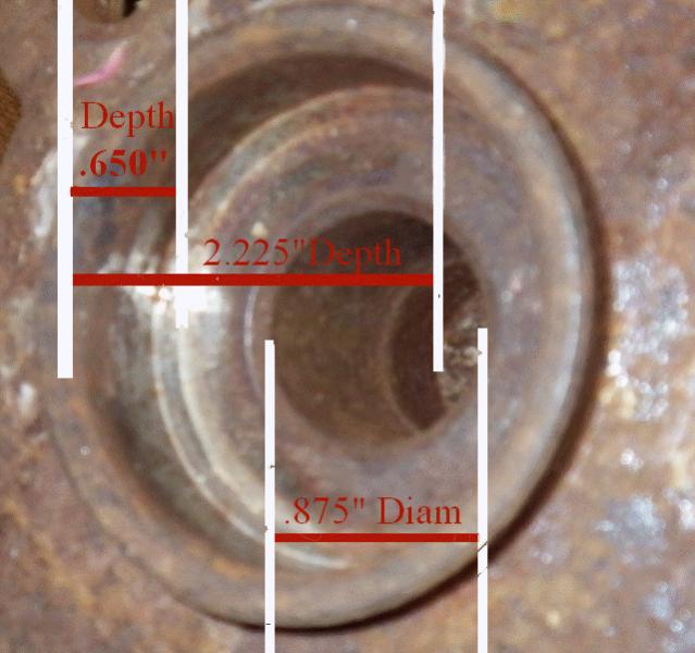

I'll look for the dims I drew up a while back. Your gonna need more than a 3/8". As I recall my '66 383 auto crank was not drilled anywhere near as deep as the picture, maybe only a 1/2" depth used for center purpose.

As I stated previously my 383 was nowhere near the 2.25" depth.
This is a never bushed 440 crank picture. Notice the step down in size. ..............

If you do drill to deep you will waste the crankshaft buy drilling into the oil gallery. Have a machine shop do this that knows what they are doing. Also make sure those used parts are good before wasting a lot of money trying to use them. I may know who you have been buying from and could be a case of buyer beware.
