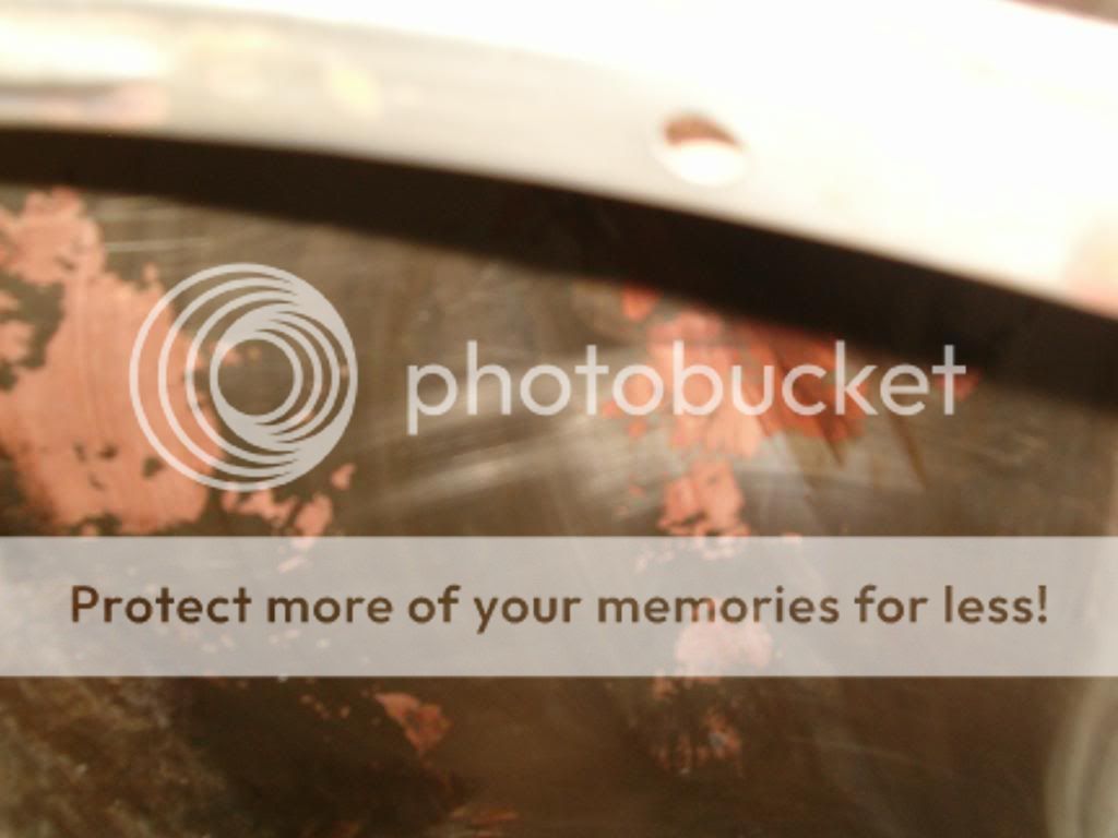

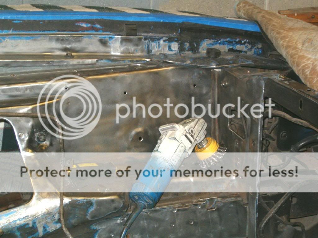

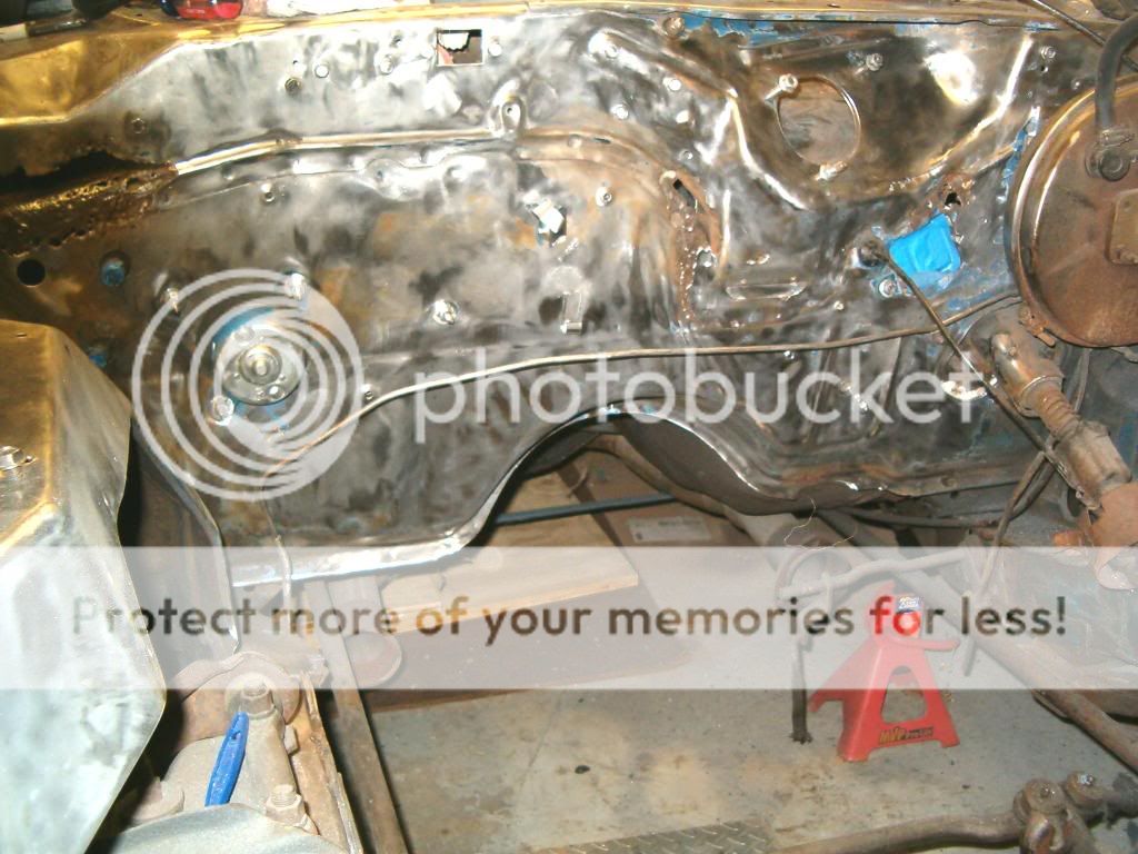

here are some photos

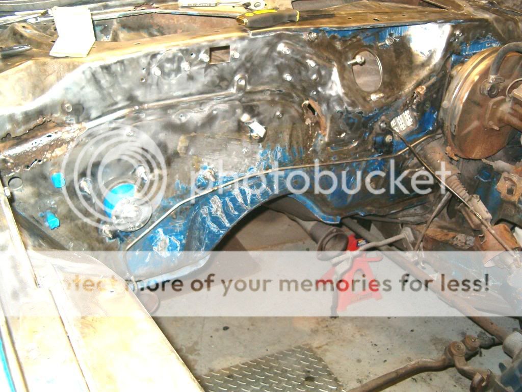

most was done with a wire wheel except a few places in the engine compartment and alot of stripper was used on the left iner fender well .

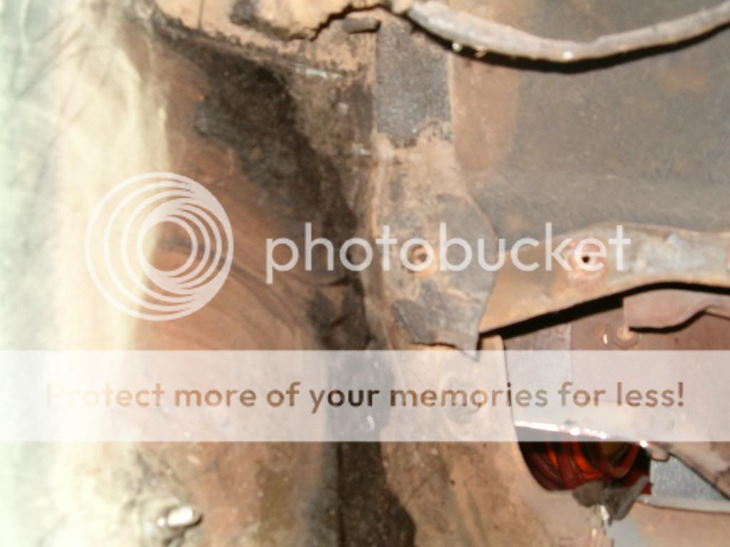

so in otherwords lets say i let the AC stripper dried and its although the seams , how do i get it back to clean metal ?
innner fender
engine compartment
