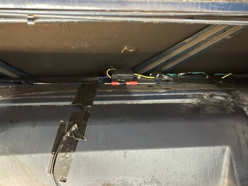

Trunk on my 67 on flat part, spliced into sender line there.. Ran a 18ga wire to it from up front for power. If do it there, have someone to turn key off and on when needed and can tell you what gauge reads if have to do Method 2, esp if have to do a reset on it as you have to hold button down when applying power. Ma was even nice enough to leave a indent to hold the screwdriver if need it again..

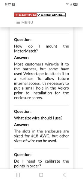

Lots of folks just velcro the box somewhere under the dash.

They have a good FAQ here.
