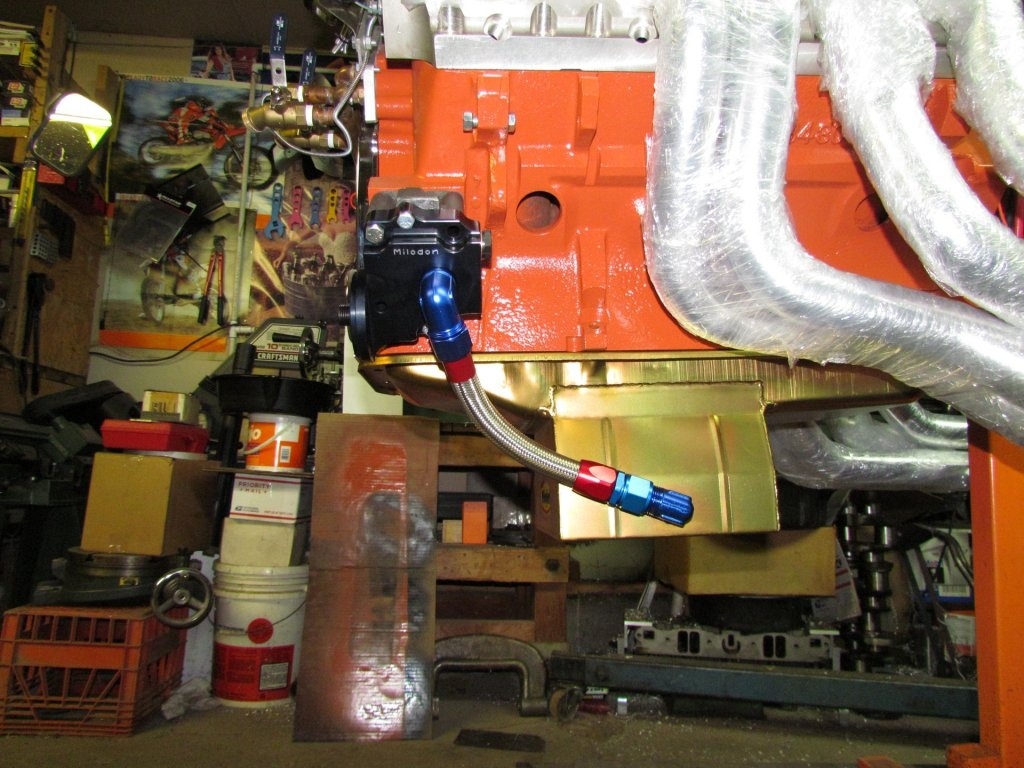

When installing any system such as this you need to plug the original hole inside the block where the stock pickup was located. Is there any reason I CANT use a brass plug that I was able to find with the correct thread or would it have to be a steel plug? I'm probably over thinking this but Ive never installed one and want to be 100% correct
Standard 3/8 pipe thread any parts store or hardware store will have them, steel is what I use. Just installed one a couple months ago.
I don't see why not. 440 block is 3/8" NPT Hemi is 1/2"NPT. I wouldn't install until block is cleaned for assembly.
the threads in the block are 3/8" straight pipe thread. the pitch is the same but the taper is less for straight pipe thread. doesn't mean a tapered thread won't work but does mean you should use some type of sealer on the plug to make sure you don't suck any air.
Never heard of SPT, I learned something. Good thing I used Lock and Seal when I put in my pickup.

You can plug the passage with a cup plug. My motor has the internal pick-up shaved off. Been this way for years.
