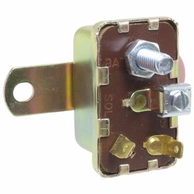

Mini starter
There is nothing wrong with using a mini starter, you will usually need to trim the main 12vt./1/4" post, so it doesn't contact the engine block, unless you get a clock-able style, they last great, even on my high compression engines & don't get heat soaked, anywhere near like the larger units, especially with headers, yes they are more expensive, the last one I had was a Powermaster 4.4:1 reduction, it spins a 11:1 479ci like no tomorrow, I have a Mopar replacement Dakota/Ram 5.2ltr/318ci or 5.9ltr./360ci, Mancini Racing MRE starter on my current 68 RR engine BB/B-Engine now too, never an issue... I hope you get it sorted out electrical issues are the worst... Ignition switch, bulkhead connections, starter, starter relay, battery, fusible link, ground or wiring...
  • Mopar Elec. Ign. wire diagram 4 pin Ballast & electronic regulator #11.jpg
