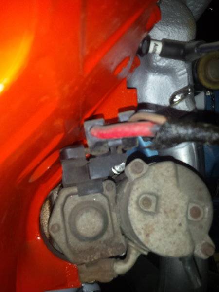

Bought this mini starter from a junkyard many years ago, and bolted it on figuring that the terminals would hit the block. So it seams that this starter already has the terminals moved to avoid this. Does anyone know what vehicle it was possibly from? I could use another one for my other big block project car. But can't find it anywhere on the Internet.
Take the plastic covers off of the starter terminals. You may find that the terminals directly at the body of the starter have enough clearance to work.

Yep, 1990's Dakota V8 starter.
I cut the large stud shorter. You'll need to mock up the amout of connectors and washer and nut then use a hacksaw or cutoff wheel to remove what you don't need.

I actually attached my wires while the starter was bolted in place. I cut the plastic adapter in half to make a cap for the terminal.
