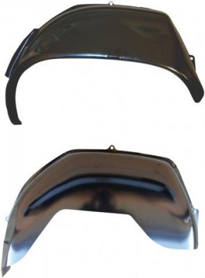

Maybe the outer wheelhouses were also used on earlier model cars, and, they just kept stamping them out for the B Body car line? Yeah, stock size tires on our car body's looks ridiculous for sure!

I got to looking at them and how they slope up smoothly into the roof so maybe it's part of the overall structural design?

Seems to me that several years ago there was a story in either Hot Rod or Car Craft on Mini-Tubbing a '69 or '70 Super B. Seems I recall them using an extra set of inner factory tubs for the outer halves swapping left for right/right for left and welding in filler strips to complete the project. If this story could be located and reviewed/reprinted it would be worth the research time.
