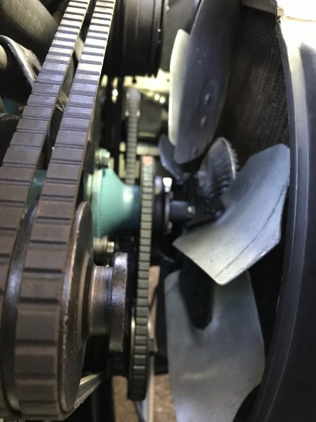

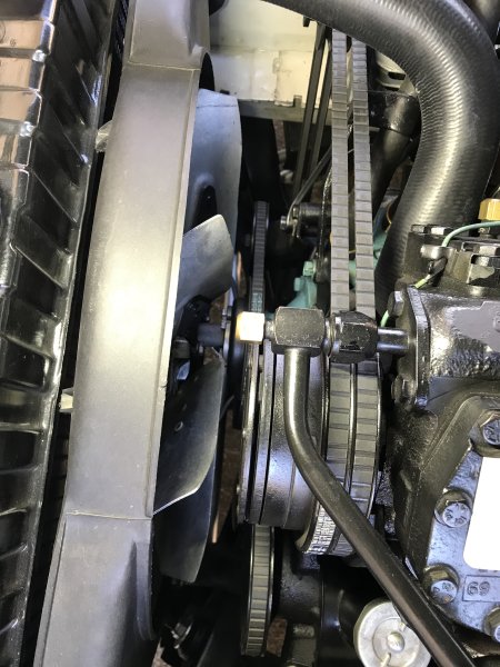

My factory AC/PS 67 GTX fan belts are driving me crazy. The belts are all new Dayco Top Cog belts. They howl just like the others I’ve tried. I’ve made sure the pulleys are all aligned via straight edges and wood dowel rods laid in the grooves, to perfection, adjusting any that were not. I’ve tightened the damn things to were there is almost no deflection. Drive along at any speed, in any gear, and just give it some gas and it howls away.
I don’t think it’s the AC belts since they are doubled up. I bought 3 to pick the closest 2 but they were all well matched. Also the screeeching doesn’t matter with air on or air off. I believe years ago I removed them for a test w/o any luck, it’s been so long I don’t remember everything I’ve tried. I have a hard time believing it’s the PS belt as it has 180 degrees purchase on both pulleys, but not sure. That leaves the water pump and idler drive belt which has more like 140-150 degrees purchase on the pulleys. I believe this is the problem belt - but not 100% sure.
What to do? Do I need to sand blast the pulley surfaces? None of them appear real slick but kind of hard to always tell where the belt is riding in the groove. The water pump idler pulley used to sit a little crooked but I worked on it some years ago and got it straight - I can’t even remember what I did to it I’ve been fighting this so long. Anybody got any ideas on this?
I would try to isolate it. Run it with the a/c belts off and see what happens. If it does it right away on a cold engine you could then try it with the a/c belts on the the WP belt off.

Two things, is that a cogged belt? Second, if a belt bottoms out in a pulley groove, it will never stop squealing. A/C belts were solid matched belts. Don't believe they are available any longer.
I've had an idler pulley bearing squeal like a belt slipping. Are you sure that is not the problem. It looks like you are back to square one. Drop one belt off at a time until you find the culprit.

Not on the bottom, clogged on top. I use stock width belts but I’ll look at them closer to see if any look that deep into the groove. Dayco’s seem to run a few thousands wide.

No, I’m not sure - it’s the same idler that was on it when I bought it 25 years ago. About 12-13 years ago I had a strange deal where it ate the water pump belt in two. I mean literally. When I picked up the belt an entire shallow, arc area had been ground out of the belt like it was being held stationary until a spinning pulley actually wore clear through it. I got another belt at a nearby store and before I even got out of the parking lot it did it again, rolling all the other belts off in the process. I had it towed home and I pulled the water pump to examine it in case it was seizing up but found nothing wrong. I put a new one on it anyway and new belts and it’s been OK since - except for squealing. But I’ve never felt comfortable taking the car far from home since then.
Looks like I need to go through pulling the belts one by one again which is a pain because the AC belts are on the outside. I may look for another idler bearing too, although I would think if a bearing it would be rpm sensitive. I can ease up to highway speed fine but at any speed just goose the throttle a little and it squeals.

I have the same belt setup on my 67 383 with PS and A/C. I had to replace the idler pulley several years ago because it started making a noise that sounded a lot like a belt squealing. Checking the belts, I noticed that the idler did not turn smoothly - the bearings were going bad.
