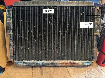

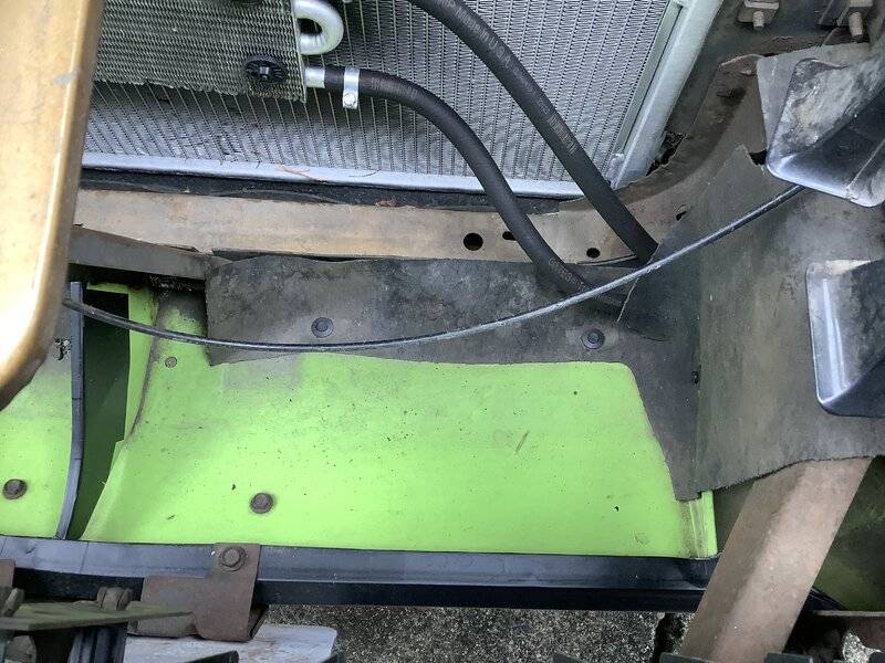

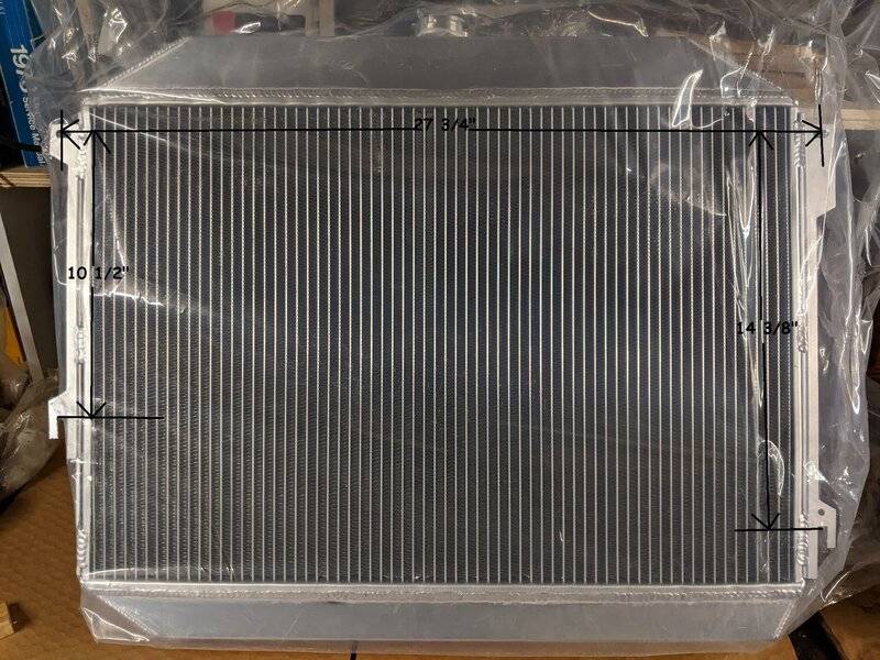

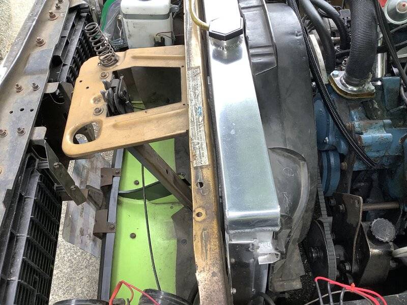

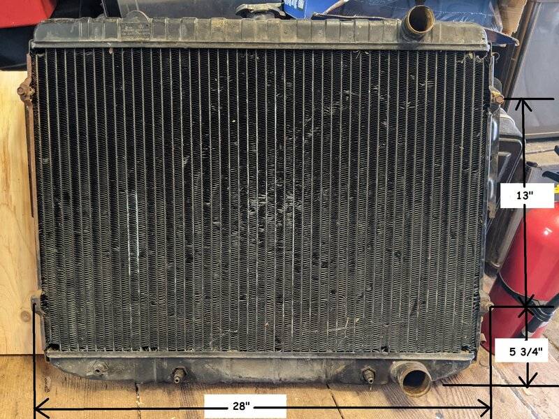

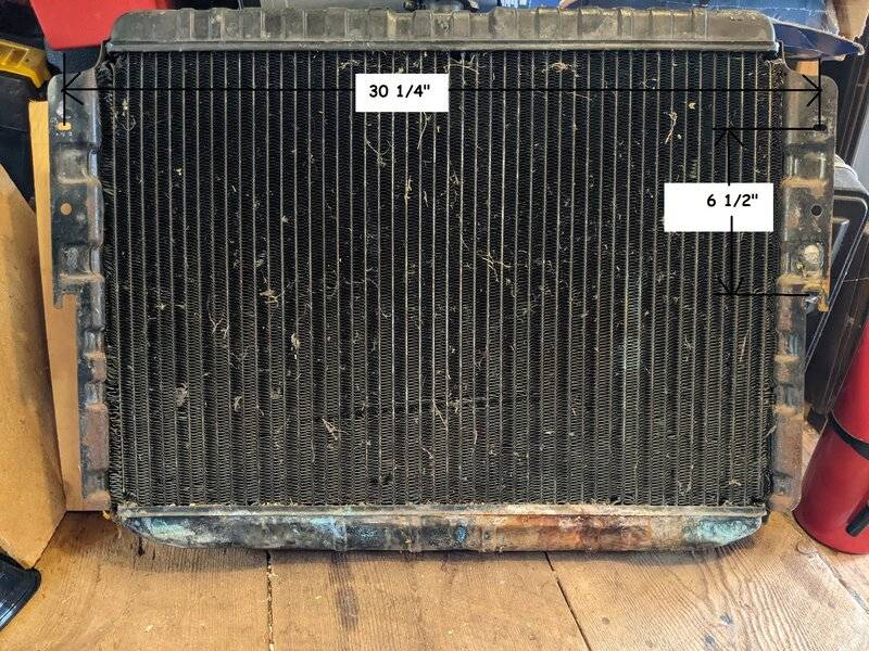

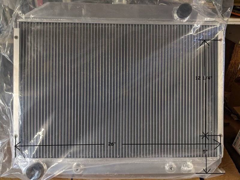

Got some pictures and took some measurements today.
I am thinking I can build a couple of brackets to mount it to the body and will have to do the same for the shroud.
Any input is welcome.

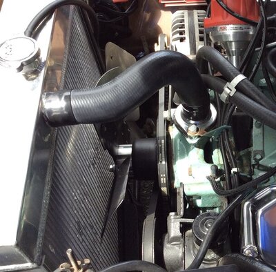

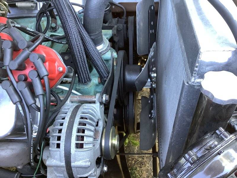

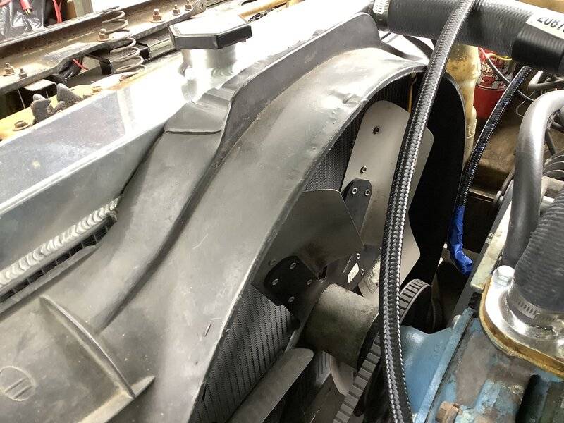

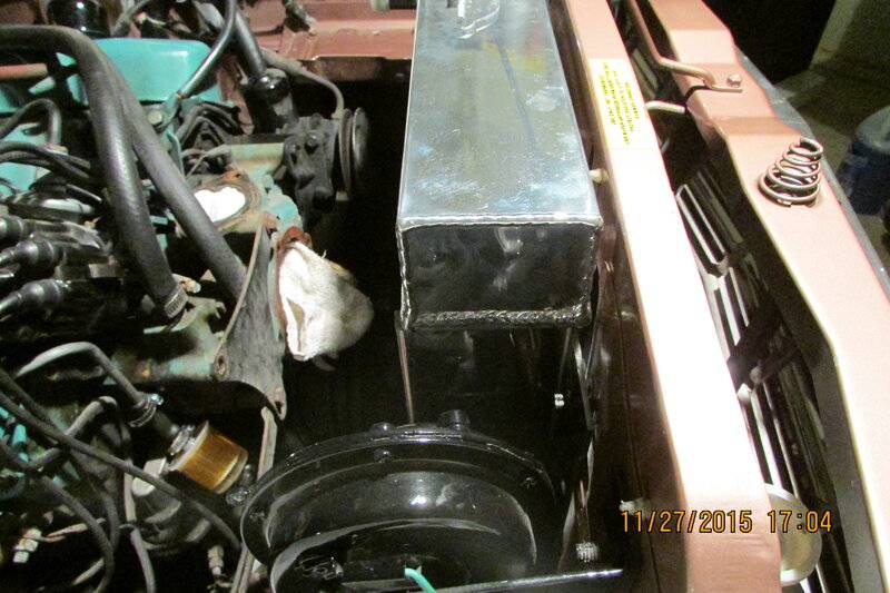

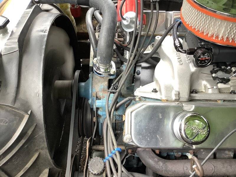

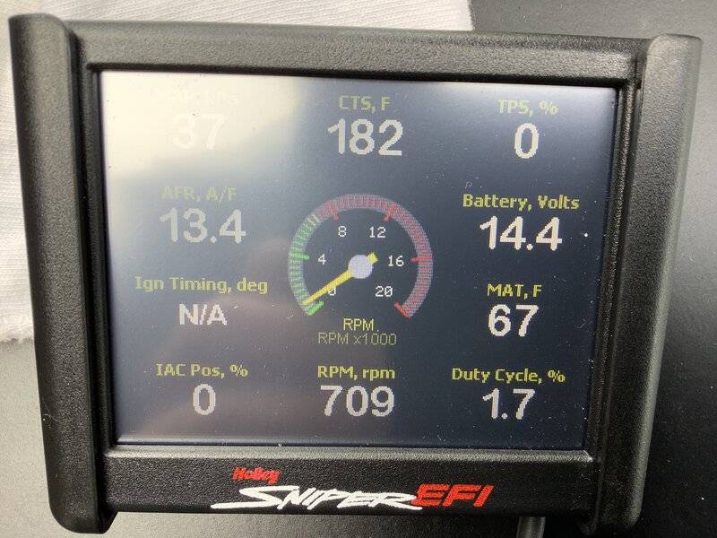

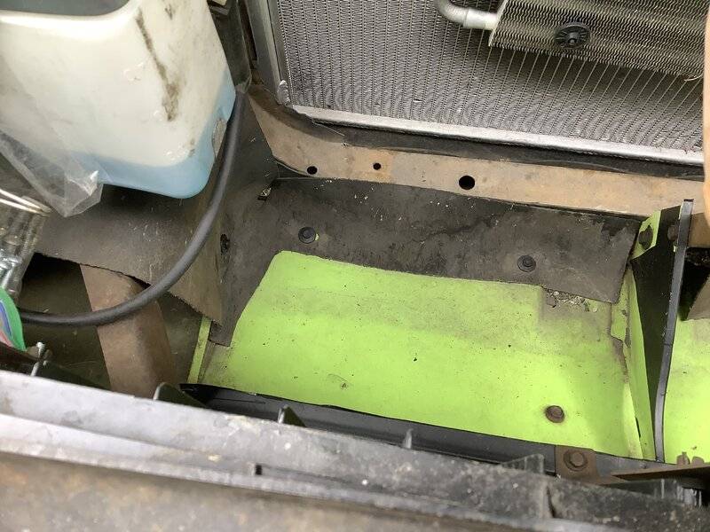

I put the Champion radiator in my 74 Charger and also in my 64 Sport Fury. The Charger has the factory shroud and only had to drill one hole on the core support and fits like a glove.
Solid flex fan and 180 t stat. Goes up to 190 when stat opens and runs consistently around 185 regardless of traffic or weather conditions. Fury does not have a shroud and runs the same way. Very simple and efficient.
Just my opinion and experience after several years with these cars and zero cooling system issues so far and that’s a beautiful thing. :thumbsup: :luvplace: :steering:

Thanks 64fury74charger. It looks like the best thing to do is send the Mishimoto back and get a Champion Rad.
