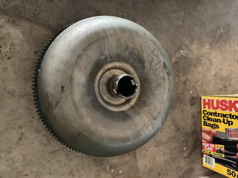

Any way to eyeball it, and or test it? Put the wooden handle of my body hammer in and spun it and it seems to move ok.

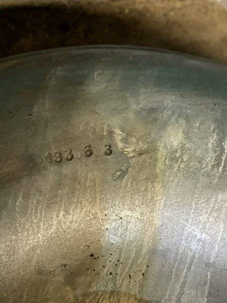

Here’s the number on it
79E59073-35C4-45AB-8786-75D68B9383FF.jpeg CF108155-6D2A-4000-B084-19EF1545CAAB.jpeg
There's a one-way clutch in there. Should spin one way and not the other.
Yeah, but one is the stator right? The other is the turbine.
When you tear down the trans, grab the stator support and insert into the converter and follow with the input shaft. Then you should be able to spin each. Look on line for a converter tutorial to understand what you are looking for.
