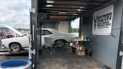

Mobile Dyno on hand... here are a few combos we are gonna put to the test Oct 19th

Muletown Mobile dyno has pledged their support for the #MoparVsBrandXstreetcarShowdown in Danville, AL. I'm going to strap my 383 in my Super Bee to it and hope for the best! Ill share some other combos I know are taking the rollers with the best info I remember about them, feel free to guess and debate the following. All are welcome and there will be plenty of time to put your car on the dyno and run down the 1/8th mile. If you want to make it out, arrive at Jakes Dragstrip 10am!

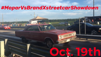

**67 GTX
440 bored .030 TRW Forged
440source massaged with upgraded springs 2.14/1.81
Hyd Flat tappet Howards 720581-10
Torker II 950 Holley DP
727, 355
*Guess 373 hp / 434 tq

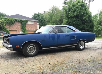

**70 Sport Satellite
440 .020 6pak replacements
440source, ported / upgraded springs 2.14/1.81
Hyd Flat Mopar Purple Shaft .509
Performer, 800 AVS Edlebrock
727, 355
**Guess 361 hp / 440 tq

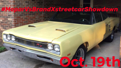

**69 Coronet R/T
440 .150 down the hole flat tops
915 heads, ported, 2.14/1.81
Hyd Flat .480 Lunatti
Mopar M1, 800 AVS
833, 3.54
**Guess 333 hp / 412 tq

** 67 GTX - 7.69 @ 89.2
** 70 Sport Satellite - 7.97 @ 88.3
** 69 Coronet R/T - 8.34 @ 84.1

It is a Dynocom Dyno so it should read even alittle higher than a DynoJet. Ill try to get my Super Bee on a different kind later to make a comparison. A friends Duster with a 360 .030 with ported magnum heads, .530ish lift Hyd Roller with a 904 and 3.21s made 317hp and 376tq on this very dyno.
I was wrong about my brothers Coronet R/T it has a Torker intake and he just swapped in some header to boot. Here it is on the first start up today. Should sound great after a trip to the exhaust shop!

That’s the good part, this is gonna be done at the track on the dyno he has a scale system so, we should get some good data out of the experiment. Seeing as how we plan to run these down the 1/8th all day should get a good idea if nothing else... food for thought.

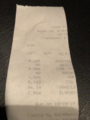

It's crunch time and all of these cars are fighting back.... charging problems started on 2 of them, starter killed over in my Super Bee, the Coronet went on its maiden voyage yesterday which came with a couple hiccups, the Sport Satellite converter was no where near enough, so that just got changed... one thing after another! But, we are all determined! The GTX is running like a top, as is a friend's comparable '73 Cuda, who just ran 7.60 @ 90mph... Saturday should be a blast and I hope some of you make the trip!
