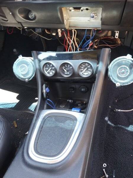

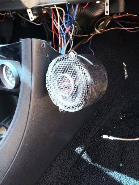

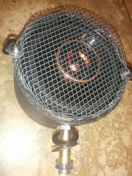

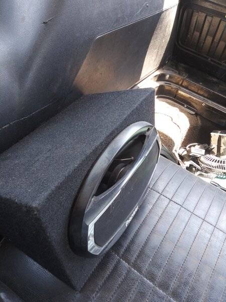

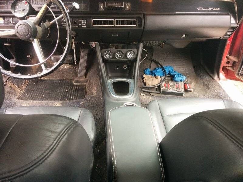

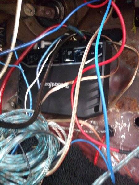

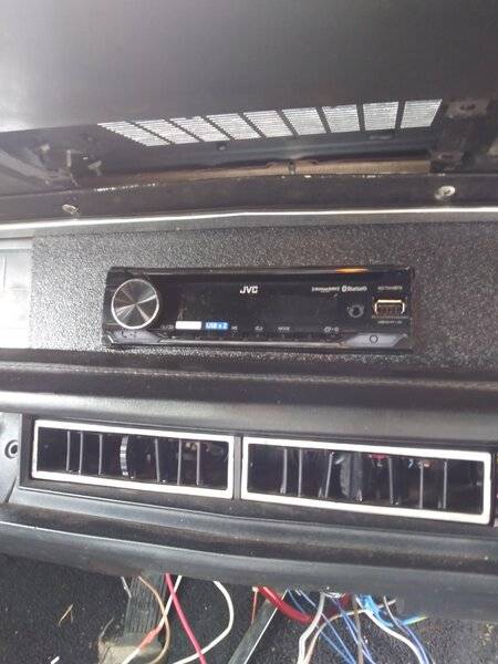

I've got a 68 Coronet Wagon that I installed a 2014 Chrysler 200 console between the 2014 Altima buckets It all fit with very little effort. I installed 2 amps, one drives the subwoofer and the other runs two 6x9's that I installed in small speaker boxes that I purchased and two tweeters. I ran the wiring out of the way but allowed moving the 6x9's when I need to fold the seats (I haven't decided on a more permanent spot for them). The subwoofer mounts under the rear facing seat. I then used PVC end caps to fab a set of tweeters and mounted them to the center console. I mounted the single DIN unit in place of the factory radio. I recently redid a few things and mounted one amp on the firewall above the trans tunnel and the other on the underside of the dash frame roof. Then installed Vintage Air and ran the wiring for Edelbrock Pro Flo 4. Next is the engine swap. I buy all my stereo equipment from Crutchfield. Let me know if you need specifics.
As mentioned I had to remount the amps and the head unit for the a/c install.

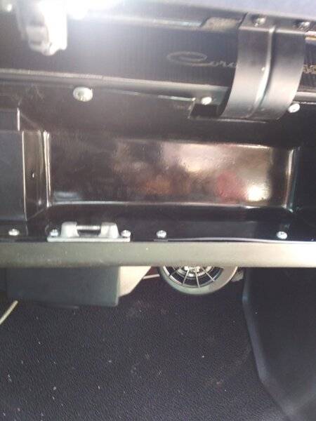

I am wrapping up the interior mods so it looks messy. The head unit was previously located in the glove box. For anyone who is looking for a stronger glove box insert, Vintage Air's kit comes with a plastic molded one that fits ok but a heat gun makes it fit better. They may sell it separately.
Thanks. I was surprised at how well it fit. Just needed to figure how to mount it.

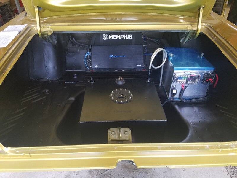

I have a Memphis sound hidden radio, with a 5 channel infinity amp, a 6" bazooka tube with infinity 6x9 in rear deck infinity 5 1/4 mounted in speaker pods at the kick panels, and I made a plate to fit the dash speaker opening with 2 infinity 3" round speakers. Everything plays through Bluetooth on my phone. I only have one complaint you have a volume almost too low to hear then next level is just a touch loud to talk, but when I am alone it is really clean, and the bass is good, yes it can go loud but I don't need loud

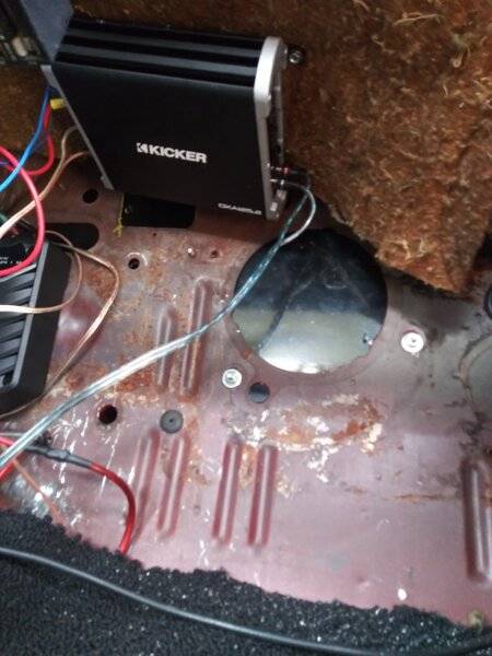

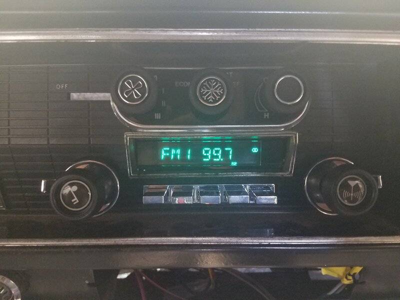

So I purchased a RetroSound head unit and I highly recommend Kickers CS speakers. I have 2 6x9 in the shelf, and in place of the 4x7 I have 2 3-1/2". I planned on installing 2 6.5s in door pods. But may be changing my mind after the initial test in my system. I also bought an 8" powered sub, my amp is a 4 channel that currently is powering just the 6x9s, the 3-1/2s are powered off the head unit. I havent even tried to dial it in yet...and again this is without the 6.5s and about 25%.
If you mount your speakers in any panels buy a foam baffle to set it in, it really helps focus the sound and keeps the tinie soundto a min.
