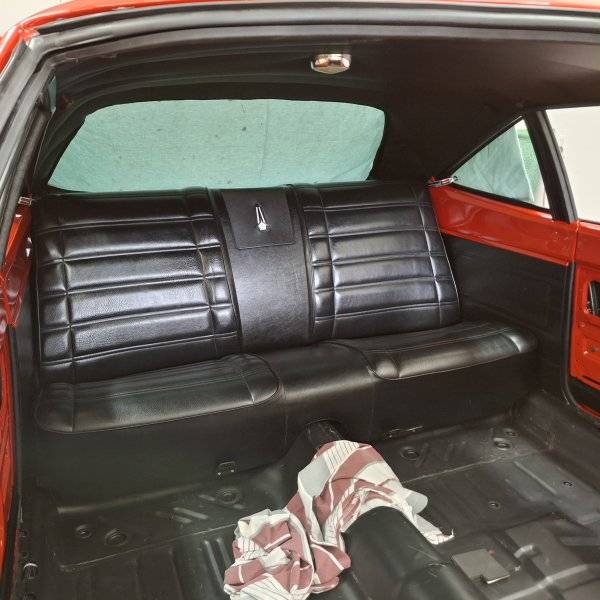

Piece of cake. I did mine with all the material still in place. Only the seat back needs to be modified - not the seat bottom. The only mods needed were a couple pieces of the wire on the back side - cut, bent inward then re-welded. I seem to recall only a couple small welds - one or two on each side. There was no cutting or modifying of the main framework. I covered things with a thick blanket to prevent any weld sparks from hitting the seat material. The welds are short and sweet so no harm done. Sadly no photos.
If you're having the seats recovered, take all the material off the seat back and then install it in place - you'll be able to see what needs to be modified.

It doesn't look like I have a photo of them, I will take a few photos later today. The tub goes to the frame rail.

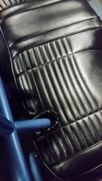

Agreed, I did my seat the same as Gkent just cutting down and reusing exiting seat material. However, mine is a E Body. Unfortunately, I don't have many photos on my phone. I also had to modify my lower half seat to accommodate the two bars that I ran from my cage main hoop that go through the seat and floor board to the top of my spring perches.

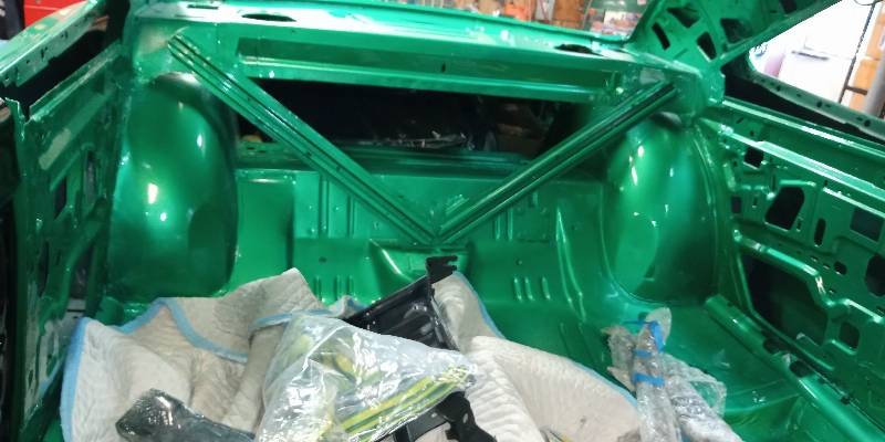

A quick photo of the rear seat area
I just noticed it loos like I'm missing the bolt hole on the passenger side
You need to install the seat belt anchors if you intend to put belts back in. You also need to re-install the tabs that hold the seat back in place. But since the car is painted you'd likely have to screw those in place.
Mine with the seay installed:
I thought the two bolt holes toward the center were for the seat belts. I should've looked it up to be sure.
From the image of the floor pan on the AMD site and my poor memory, the two outer seatbelt bolt hole brackets are welded inside the frame rail. I probably won't be finding those.
I think I can weld a couple of brackets right beside the frame rail with minimal damage to the paint. I've got a parts car I can get those from.
