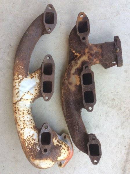

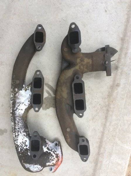

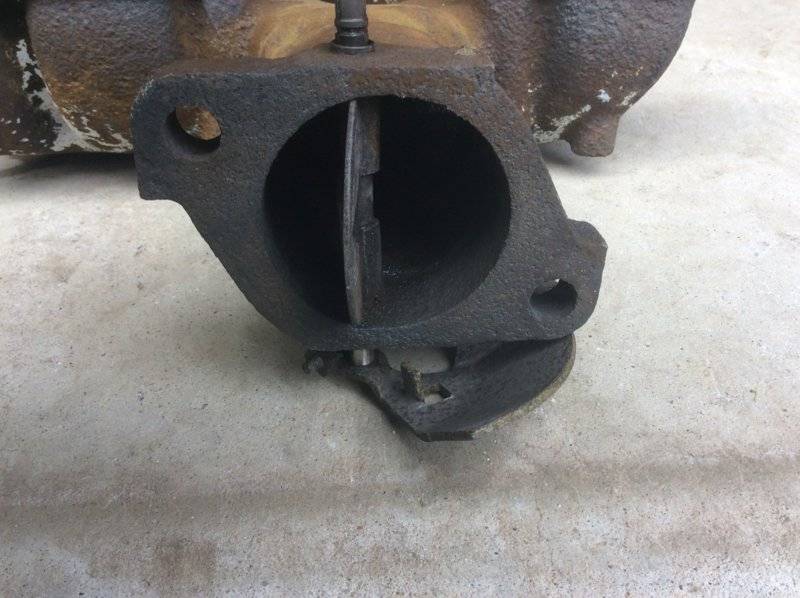

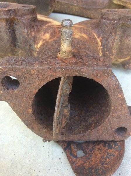

I just got back from vacation so I pulled them out and hosed off the heavy rust. I have to say that I am pretty happy with the results especially the insides. I threw them back in until I have time to clean the paint off and coat them.
Before and after
