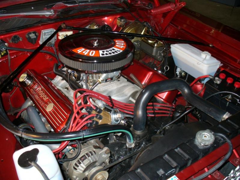

I've got them upper molded hose blues too. '73 RR, 440, no a/c, 26" radiator (of unknown heritage) with inlet on driver's side. The car had a flex hose when I bought it.
I was going to make a form w/ a coat hanger and browse the hose wall at my local parts store...
and
I went down to a local independent auto parts store and went through his assortment of molded rad hoses until I found one that was the right shape and size. I don't like flex hoses either.
Been there, done that multiple times at multiple parts stores with multiple coat hangers too ha ha ha ha. This monstrosity is the best I could find so far.

Does it look like that 20875 might fit mine too? I seriously need help. It's embarassing to open my hood.
Look at the one on Rock Auto for a 68 Charger with a 383 2 bbl.
I wasn't satisfied with the 20875 hose and found the OE Mopar part number and crossed it to a Gates 20630. Fits like a glove.
Sorry kb73rr, my inlet on the rad is on the passenger side. The 20875 would only fit right hand inlets.
