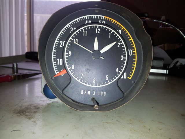

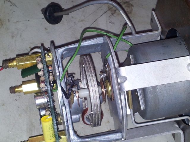

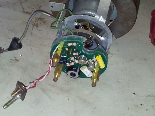

I bought a tic toc tach and put a new tachboard in it and added it to the guage cluster.

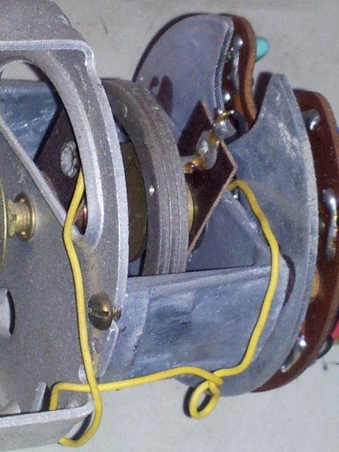

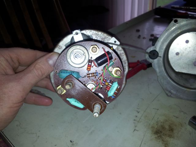

Old board has the yellow wiring which you can see neatly routed so as not to cause any interference. The new board has the green wire. Even though I wrapped it around the same way and tested for interference, once I placed it back into the case it obviously had moved a bit, because it caused the tach needle to hold up in the upper rev range. In hindsight I should have taken more care to bend it the same as the original but I didn't realise the importance of it at the time. I took it out again and held it down low toward the board and placed a bit of glue there to hold it. All fixed. The photo is before I glued it.

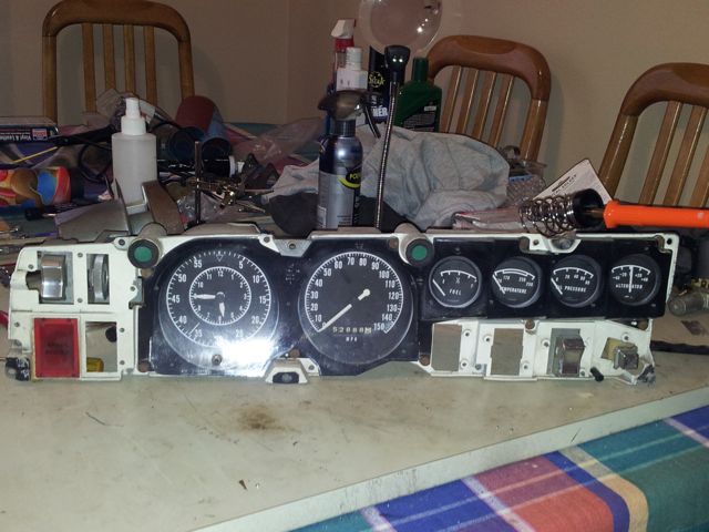

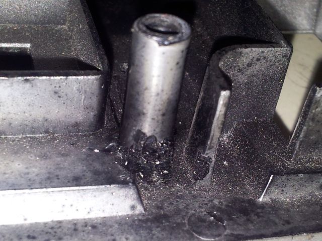

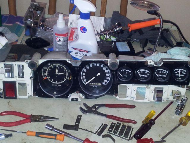

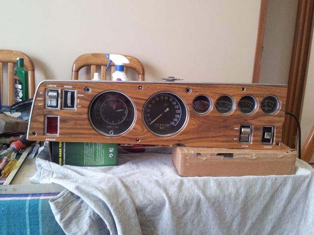

Put new indicator lenses on and a new brake system decal and gaskets. Cleaned up the plastic and chrome switches and put it back together again. I would have had the bezel placed back on as well but I realised that one of the bezel mounts was broken. I glued it back on and I'll let it sit overnight. Tomorrow I'll melt some plastic around it to hopefully strengthen it up before screwing the cluster back to it. The new indicator lenses are a darker green than the old ones. Not sure if the old ones were original or not so I'll see what it lights up like when its all back on the car.

Try and test run the tacho before you refit the cluster to the dash....might save some grief down the track.

The bezel screw post came up nice and strong, so I attached the cluster back to the bezel and all looks cool again.

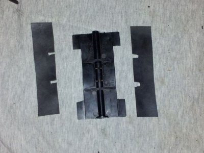

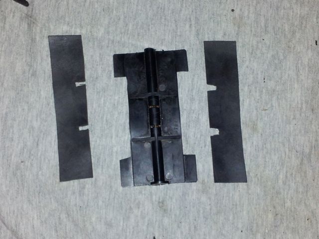

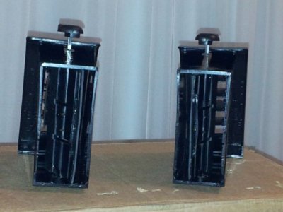

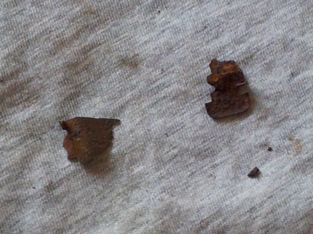

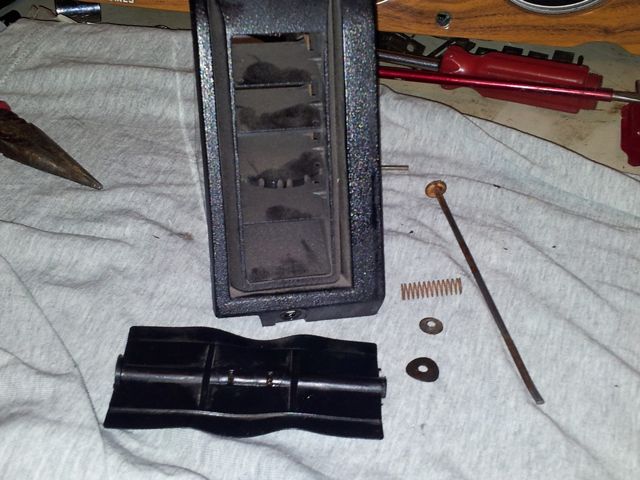

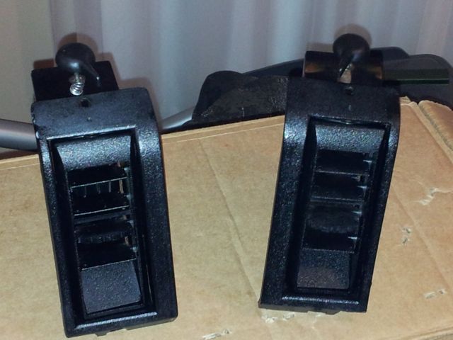

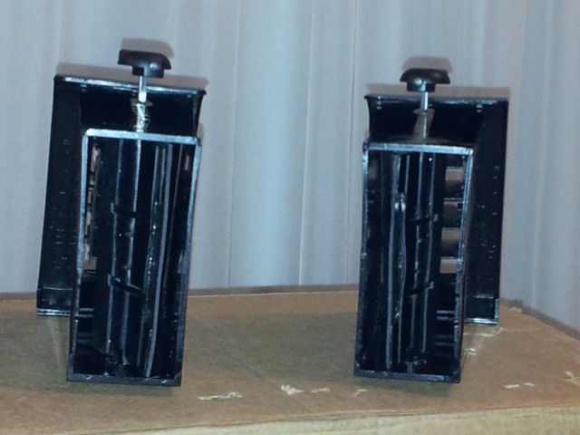

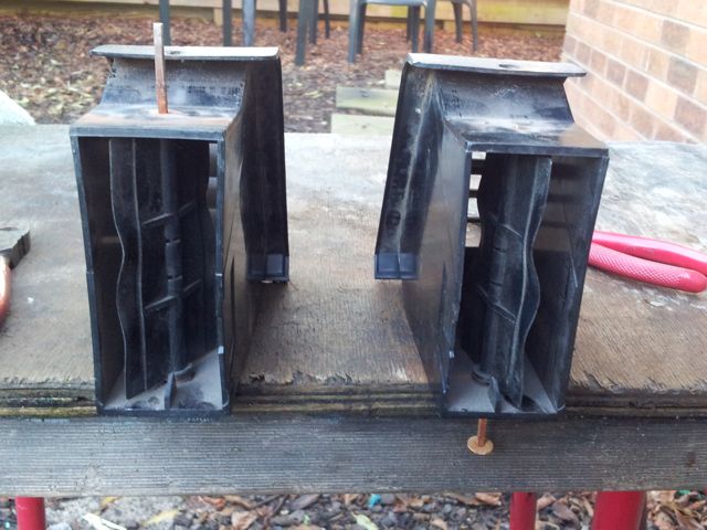

I pulled apart the ac vents and cleaned them up. The old plastic door had warped over time so I glued a bit of thin rubber to it. Seemed to do the trick, only time will tell how the glue stands up to the heat and cold coming through the vent. The metal pieces had a bit of rust, but it all freed up fairly well. I didn't take the actual swivel vent off as the pins looked a bit fragile. Since it moves ok I thought better to leave it. The only thing I couldn't replace was a couple of clips that went under the swivel vent. Seemed like a tension spring clip to keep tension on the vent when you move it left or right. The clips were rusted out and just fell apart. A:C vent 1.jpg A:C vent 2.jpg A:C vent 3.jpg A:C vent 5.jpg A:C vent 6.jpg A:C vent 7.jpg

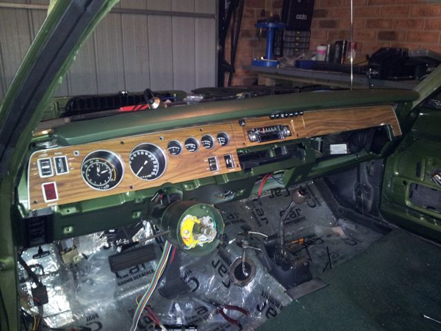

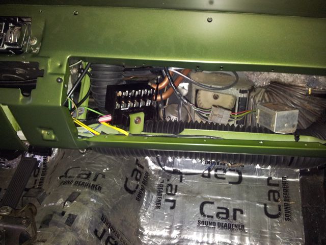

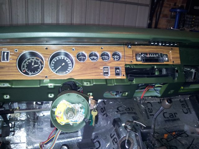

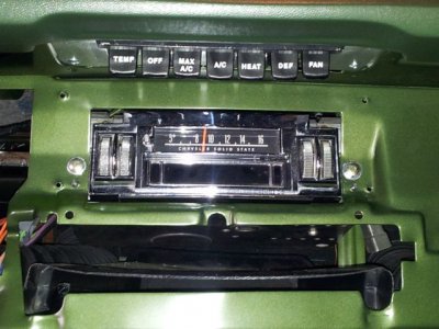

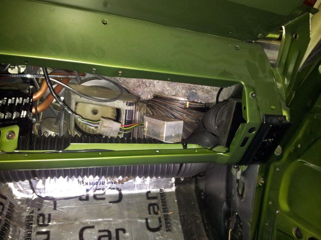

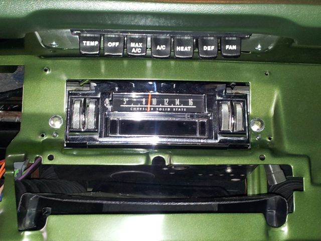

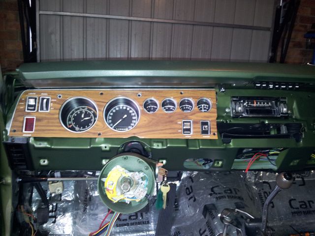

Put the radio in the dash and got all the wiring and ac ducts tucked away as best I could. Sure is hard to work around those ducts and keep them out of the way. Still couldn't get my 8 track working properly. Still sounded like the chipmunks and then the motor seemed to stop working at all. I can't afford it at the moment, but I think later on down the track I'll take it out again and send to Barry's 8 track for a full repair. At least the radio still works at the moment. Put the instrument cluster back in hooked up all the loose ends. Starting to take shape again. I think I'll leave the glovebox out for the moment so I can still get in if I need to.

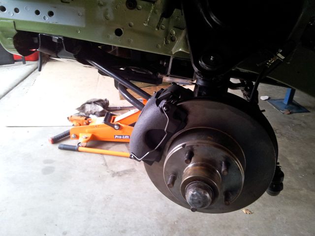

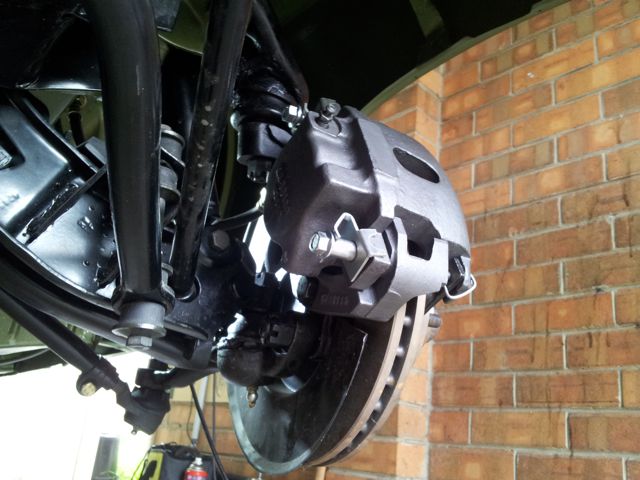

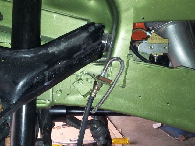

Finally got around to putting on the front calipers. Have had them sitting around for awhile now so finally pulled my finger out and put em on. Wasn't sure about the anti rattle spring placement. Could'nt find any decent pics of it as original. Have I got it sitting on the right way, or should the bar go across the top of the caliper?
