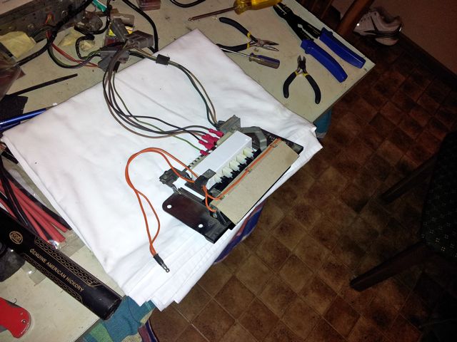

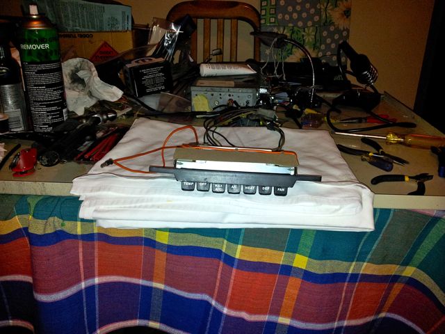

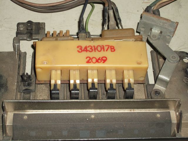

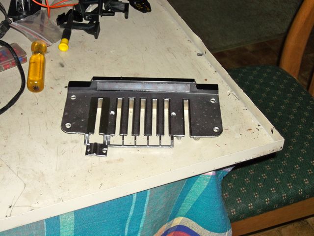

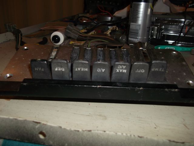

Cleaned up the ac/heater control unit. Had to purchase another switch unit as the original was falling apart and the vacuum ports on the rear were'nt in very good shape. All ready to go back in and hook up.

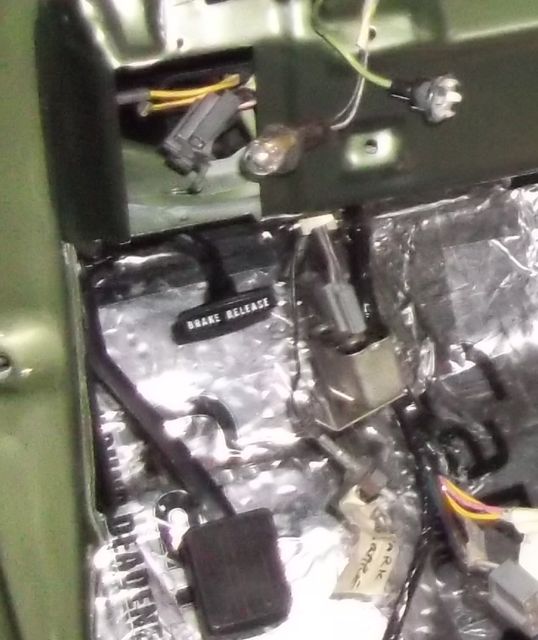

I was gonna paint them but they're not engraved lettering. Probably originally done with a stencil. Since my hands not that steady, I went with the lettering decals from Performance Car Graphics. Don't know if they'll last but they look ok at the moment. I painted the lettering on the brake handle, but that was easy because it was engraved. I could fill the groove up with the paint brush and wipe the excess off the surface without having to worry about wiping away the actual lettering. :VB toast:

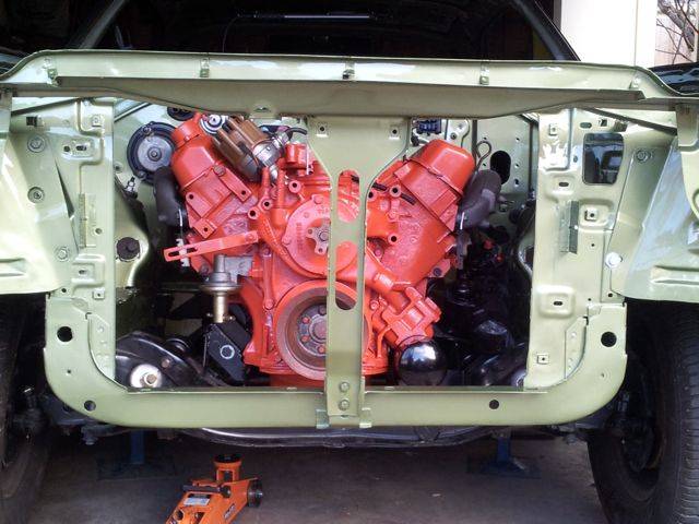

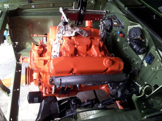

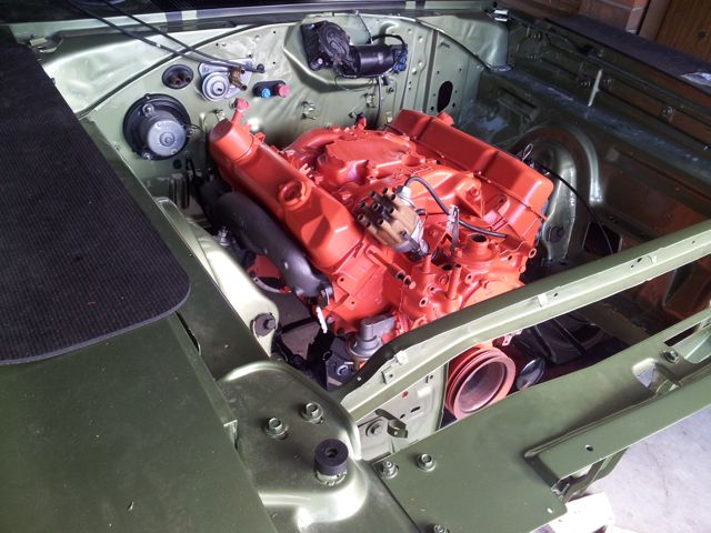

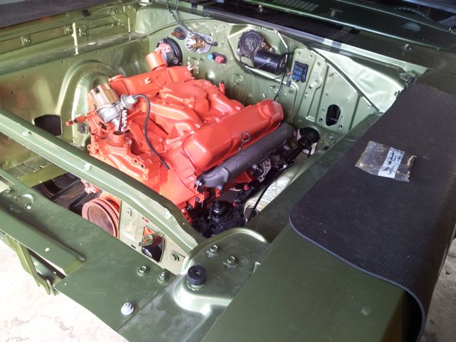

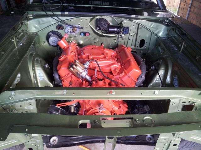

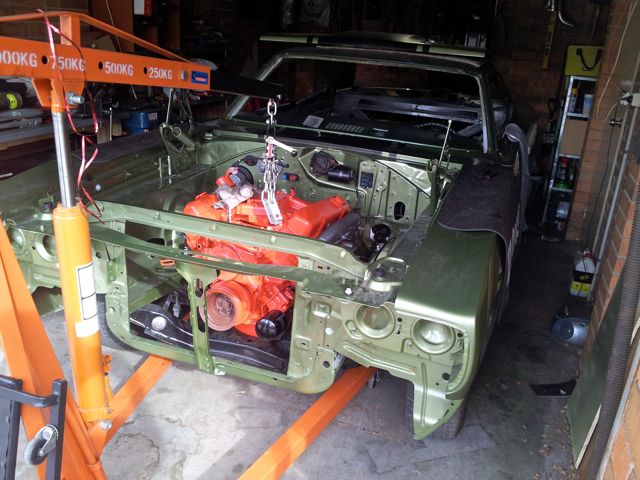

Put in the heater controls and rear defog switch but forgot to take a photo. I'll grab one for next time. Still haven't had a look at the pinch rollers on the 8 track yet guys but I will soon. Dropped in the engine and gearbox over the weekend so finally starting to take shape. Also clears a **** load of room out of my garage. Good to have things sitting in the car for a change rather than all around it. :icon_super:
