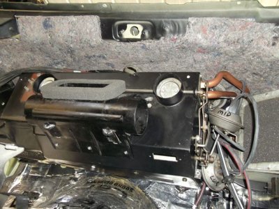

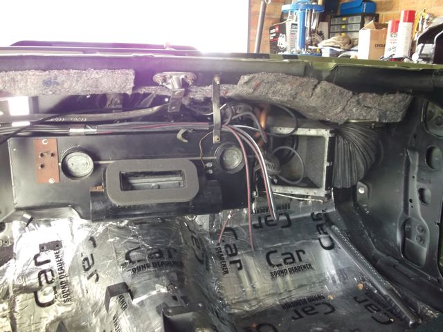

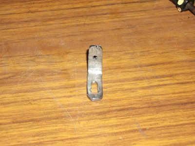

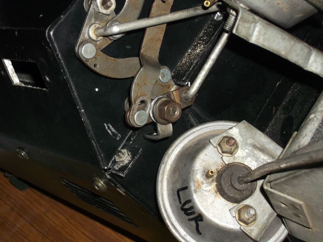

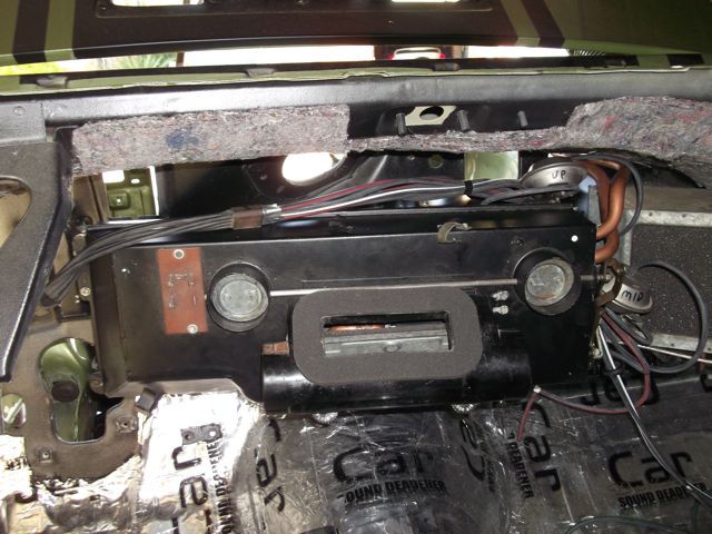

Turned out that I had the linkages all wrong on the ac/heater box. I took photos of when I pulled it apart, but they turned out to be wrong. Couldn't get the doors to operate correctly. After a long and frustrating time I did a google search, that led me to the charger forum where a bloke had restored a 69 unit. He had the linkages set up a little bit different than what I had so I changed mine around. Still couldn't get the bloody thing to work right. :BangHead: Turns out I was missing a piece. An elbow that goes over the heater door rod after the other linkages are on. I ended up making one, not too pretty but seems to do the job. Still missing a spring that goes from that elbow to the ac door linkage, hopefully I'll be able to get a spring from the shops in the near future. At last I'm starting to put things back on. It's been a long time coming but it's getting there. Time for a cold one I think. :beermug:

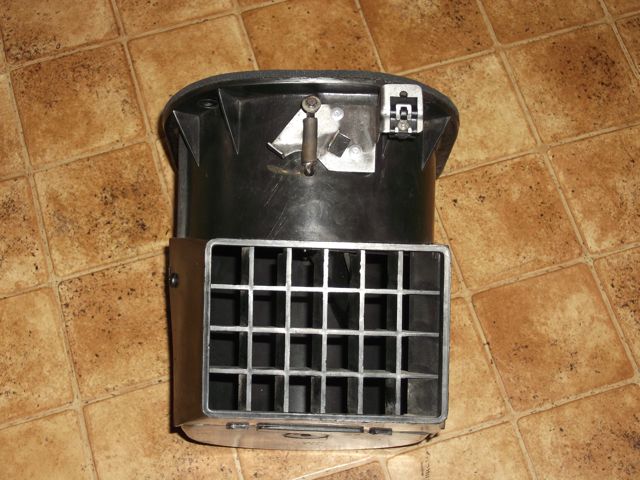

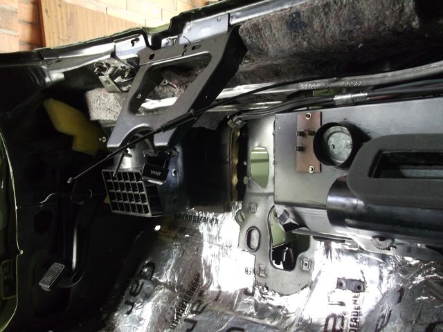

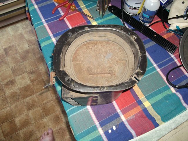

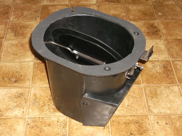

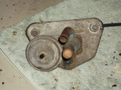

I took the ac/heater box out again because I forgot to put the last of the insulation up there. Also I was bit worried about having to work around it putting the other stuff in. (I never said I was smart) While I've been waiting for some cables and ducts and vents to come from the States I've just been cleaning up some of the bits to bolt back on.

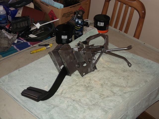

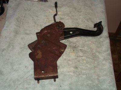

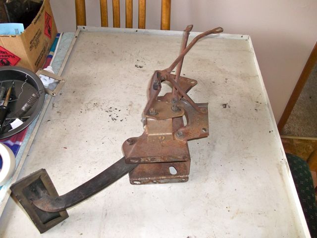

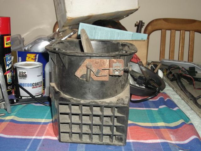

Cleaned up the brake pedal mount and coated it in clear to keep it nice.

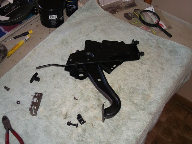

Took a bit of doing but managed to get all the rust off the park brake and gave it a couple of coats of paint.
Tubbed up the plastic as best I could and cleaned up the metal bits and painted the vent black and the rod and switch a coat of clear.
A new seal over the top to finish it off.

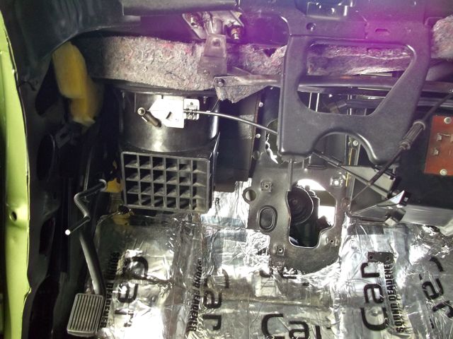

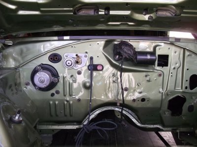

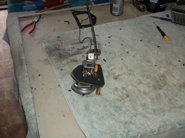

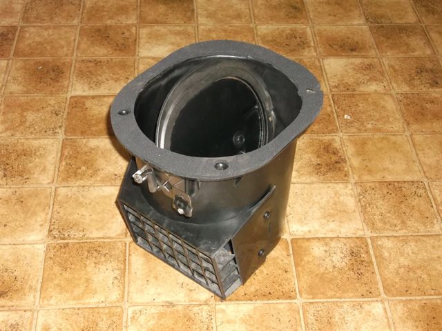

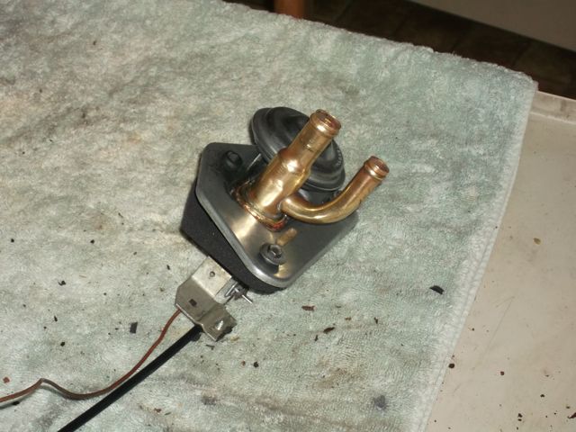

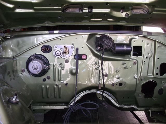

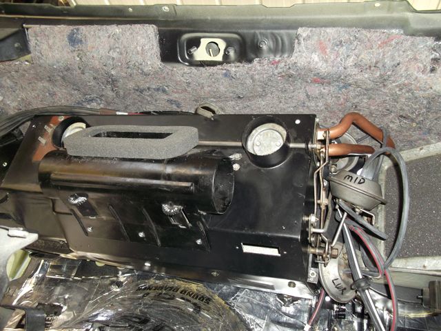

Put a couple of things back on over this weekend. Water valve actuator, driver fresh air box, passenger fresh air duct, ac/heater box (again), park brake. Put a kit through the steering shaft coupler, forgot to get a pic of that. I'll take one when I put it back in. Cheers for now.

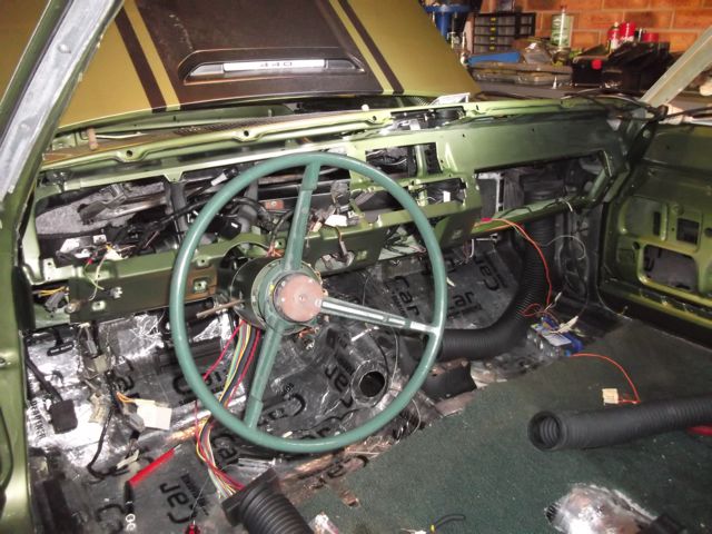

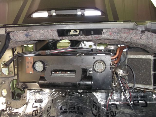

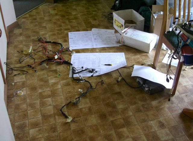

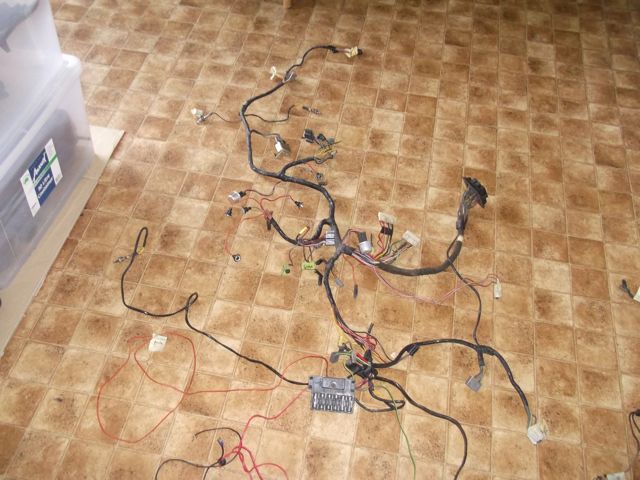

Been a bit busy lately so haven't had the chance to do much. Made one wiring loom out of two because of past damage to the original. Took me ages but I think I got it alright in the end. Put in the dash and starting to place the ducts and wiring in some kind of order. Gets pretty crowded in there with the a/c ducts.
