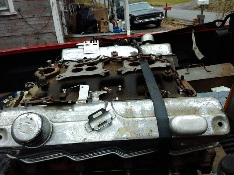

ok ... do i want to put the dual quad poly in her or the dual quad 383 or the lame smog 440? the 413 ain't savable. just looking for some input to help make up my mind.

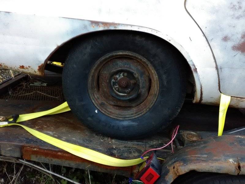

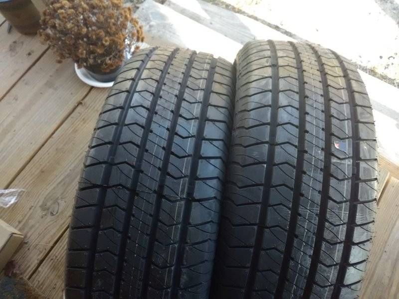

That was fast.... 255/70/15. Should fit nicely in the wheel wells.

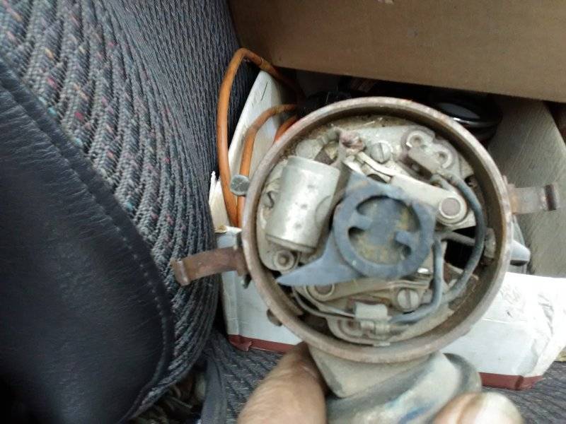

Had to take everything he had.... 3 sets of carbs. Boxes of E body stuff wheel covers and who knows what else. And told me to come back next week and get the rest of the stuff in the shed he ain't dug out yet....
someone spent alot of cash on this thing... starter t/c water pump oil pan clutch linkage bell housing try Y headers nuts bolts brackets fan ..... are all chrome.... who spends the money to have the bell housing chromed??? bet it was a nice T-bucket...
The 255/70/15 Mite be better on a 8 in wheel. But squared up nicely on the 7

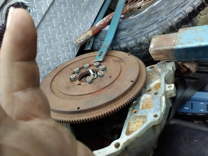

i know some of you are wondering how im going to get a 833 behind a 58 poly... lucky for me the engine is for a stick car and came with the correct 8 bolt flywheel and has the correct crank to take the pilot bushing and pass car bell housing and the mods to make it work has already been done. BUT i am going to have to make the hole for the front bearing retainer bigger for the OD trans i will be using. if the bell housing was for a truck or the engine had an auto trans crank it would be a monster mess to put a 833 on it. will post pics when i put it all together.
Does that crank have the extended rear portion where the flange is not threaded, but the flywheel is attached with studs and nuts? If it does, the measurement from the back of the block to the crank flange is going to be different. You might have to use a '62-up crankshaft in it.
it dose have the early crank... but it has the original bellhousing (that has been chromed lol) and so forth and was a stick crank to start with. if it was an auto to start with. id keep the top end and file the rest ..lol

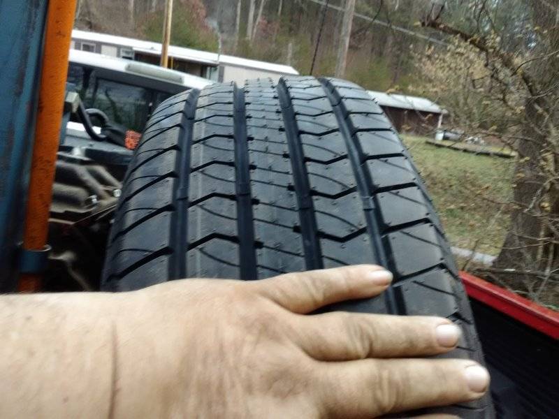

I could have put a bigger tire in there and still have room. And more good news.... 3.91 sure grip... Yeaaaa
