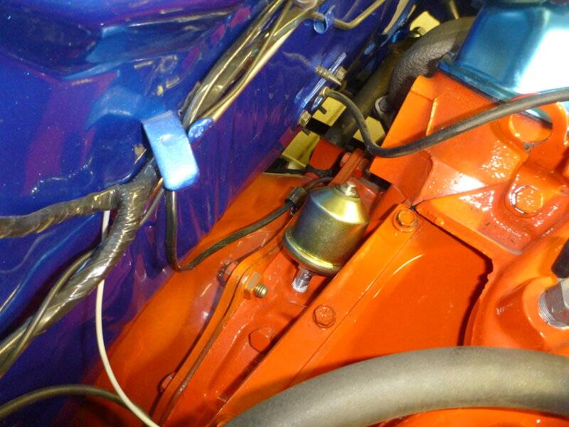

My 440 is a '70 as well. The dash gauge oil pressure sending unit has fit in it forever. My mechanical gauge line is in the other port.

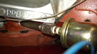

Screw all that. This old sprinkler guy took the easy way out (and made it easy to swap the
sender out in the future:
(Yeah, I know....it's redneck. Don't care, works for me. :-) )
