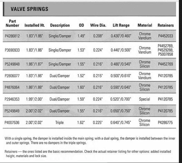

Shouldn't be too tough to figure out.... in the old days that would likely call for the Hemi spring #933's or green stripes they were called by DC (mp)..
Do you have a catalog number or manufacturer for your cam??
Looked at an old mopar performance catalog...it said use exactly what I told you; P3690933, so lemme see if I can find the specs on that....1.83/1.86 installed hgt, single w/damper, 1.53 od, .224 wire Dia, .440 to .500 lift range, chrome vanadium, use P4452033/P4286573 retainers. I have to dig out a different book for the spring pressures.....had a little trouble finding the pressures for comparison sake...maybe Mancini can answer...they still sell that spring...there are many others that could work well in that application;

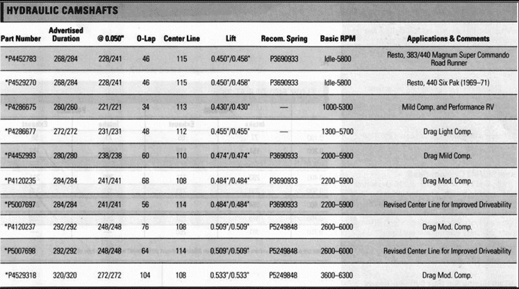

There's these out there...

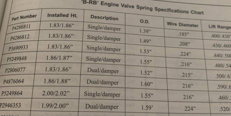

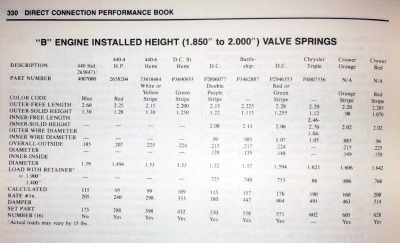

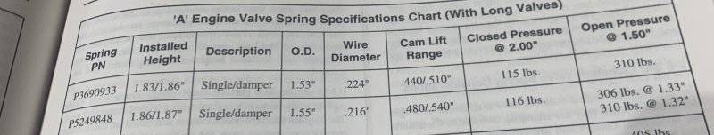

Below is what I found for spring pressures in the small block and big block books.
Small block top picture shows the same spring number so I took two pictures and the installed specs are the same in height.
