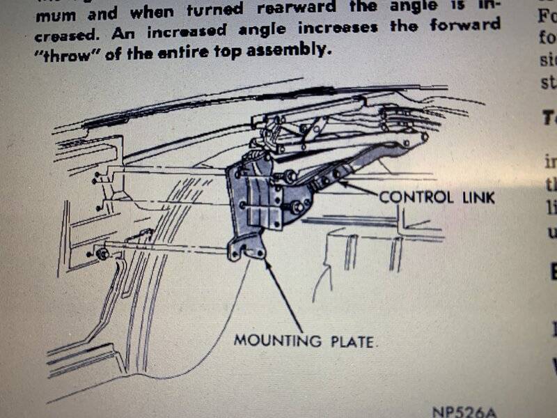

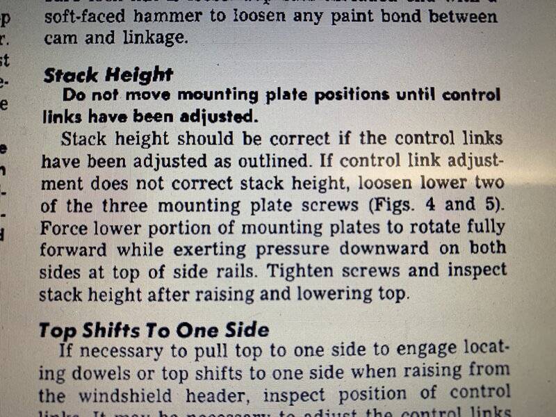

Hi there, does anyone know how to adjust mopar b body convertible tops to sit lower in the top well? I am working on a 70 Roadrunner and the top sits really high when all the way down and when its down the top cover doesn't stay buttoned in.
You’ll want to download the FSM. It is available from my mopar.com
snapshot from the FSM on adjusting the “stack height” after some other adjustments are checked and verified.
When the top is halfway down the the frame scissors the padding. Pull the paddle so it allows the frame to stack better.
