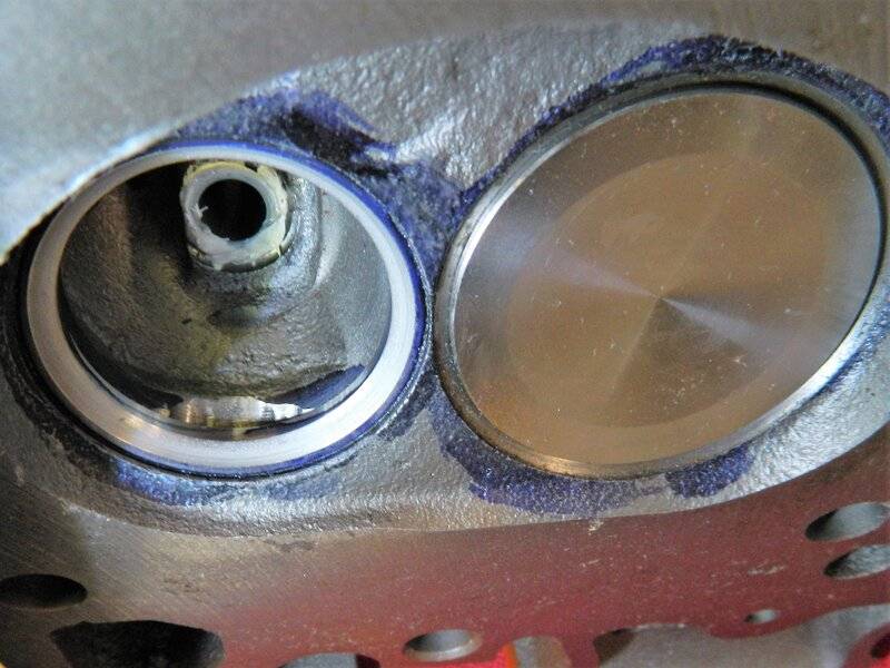

FWIW..... the current valve seat work(valve job) doesn’t look great.

Keep in mind I’m looking at a pic on my phone...... and there’s blue dykem on the seat area...... but I’m not seeing a hardened ex seat.
Take some carb cleaner and clean the dykem off the ex seat area and get a couple more up close pics there.
The way the valve job is done, particularly on the intake side....... at least on the one shown....... the flow will be down compared to what it was when it was new.
A little bowl work...... and I do mean “little”...... would be worthwhile imo........ if the build is at least somewhat “performance oriented”.

That being said, judging by the looks of that intake seat, I think it’s a pretty safe guess that the intake seat being sunk is the bigger offender here.

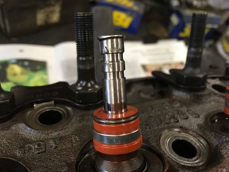

I had some previously reworked SBC DZ-302 heads in here last year for some updating.
It looks like there was possibly an issue with these similar to the OP’s where the tip heights varied, and it was resolved by grinding, what appears to be too much, off the tall ones.
And then you get this:

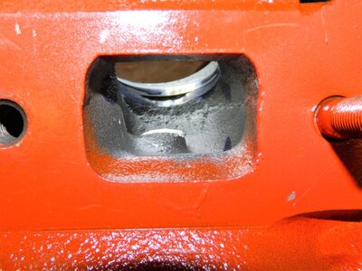

Thanks for all of the advice. I haven't had a chance to get back to this forum or to look at the heads again until now. Unfortunately, there are new issues. Please see pics and let me know your thoughts on if these usable or not. Thanks.
DSCN5401.JPG DSCN5403.JPG View attachment 952466 View attachment 952467
Well, that’s a curiosity for sure.
Why someone thought there was a need to grind that area of the original seat away is the question.
Or, was it merely an “oops” moment?
As long as there is still some material back by the perimeter of the insert for it to sit on in that area where the grinding was done, it should be fine.
I highly suggest you have a qualified shop give those heads a thorough looking over before putting them into service.
