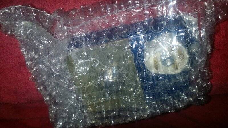

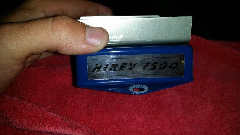

PERFECT timing on posting this, thank you very much. Yes we have 2 of them and they are fantastic in my opinion. WELL worth what he charges for them. Here are a couple examples from our experiences.
Example 1) We were having engine problems in our stroker 440 c-body, it kept stalling when it was warmed up and we tried everything we thought was wrong and it turns out it was the brain. We put the Mr. Rehrenburg brain in and the car has never run better, no more stalling.
Another example, example 2 our '66 Charger build.) We started the car the other day since the engine was put back in the car, it was turning over and farting but not starting. Turns out like our c-body stroker it was the brain, we put in an Rehrenburg and it started right up.
Just one guys 2 cents.......

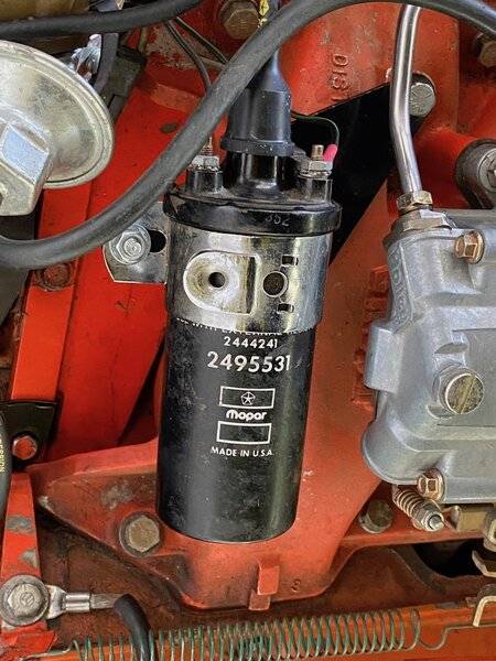

Is the Ehrenberg HiRev 7500 ECU compatible with the Mopar coil 2495531 shown below?
What ballast resistor should be run with this ECU and coil (below, if it is compatible)? .5, .7, .8 Ohm or higher?
