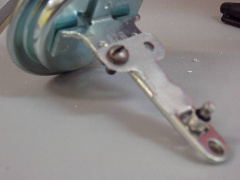

Here is what I came up with on my GM distributor.
I don't know if it is just coincidental but several years after I did this and posted it on the Corvette Forum someone actually started fabricating a nearly identical bracket (a bit smoother and better quality) and selling them for a nominal price. Not sure if he got the idea from mine or just great minds (ha ha) think alike. Didn't matter, it's helped a bunch of guys out.

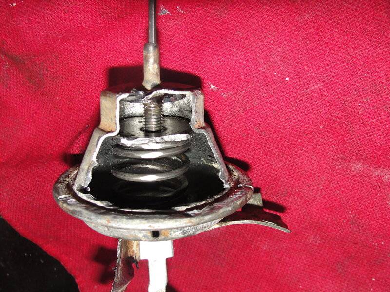

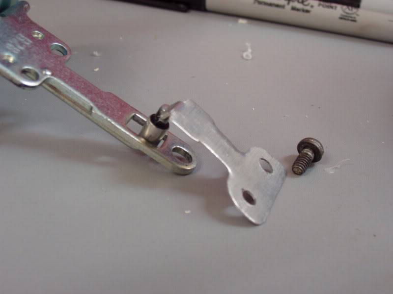

kind of shows it all G You can crank it full ccw and it will barely move. Realy depends what the vaccum is. Really starts the advance when it goes to the min set then the highest say 15 it is full in always when testing them. I get what you mean though. But to set it like a mechanical stop no. I am working on that have a prototype I need to get made. and aso the pattent.
Pics are great! Thats why the army made maintenace comic books!
Thanks for that pic, Ray. I've always wondered what was inside one of those.
