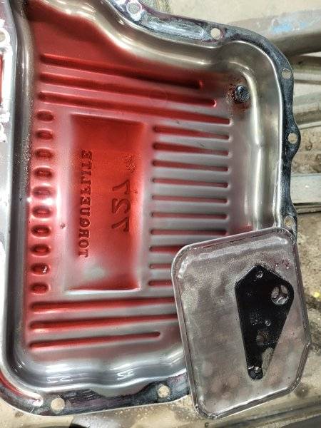

I removed the pan this morning to do an air check.
There is a little metallic stuff in there.
Can't help with the shifting.. but when i did my trans and pulled the pan after not many miles i went into panic mode cause of glitter, called Cope and he laughed and told me that's normal from parts just meshing on a new build. not sure how many miles are on yours but mine looked the same or worse. I actually pulled my trans and built it again cause it made me so paranoid, didn't find a single thing wrong.
That is what i was hoping to hear!
Might have 500 miles on it
mine looked like that at 40.. i have maybe 200-250 on it now without any issues. Someone else will chime in if i'm wrong.. I also see it as, i know how to fix it if it dies anyway.. so no biggy :)

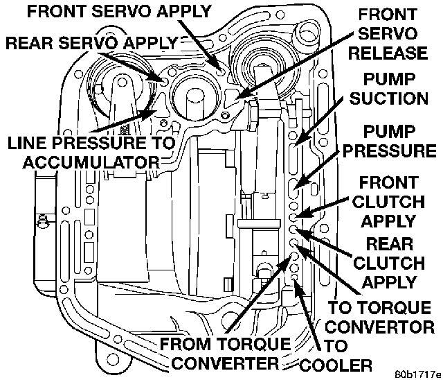

I dropped the valvebody and did an air test on the front and rear clutch apply ports.
The rear makes a solid thud noise when air is applied and when it is released.
The front makes a different sound when air is applied and no noticeable sound when released.

You are on the right track. If the front clutch application is slow, a sloppy 2/3 shift will occur. Either the fluid volume is delayed by a sticky valve or there is an internal leak. Since the valve body has already been removed, start there first. A call to Trans Go’s tech department is a good idea. Sometimes it takes them time to get back. But they will. They are very knowledgeable. If the valve body checks out then I’d be looking at the reaction shaft rings and front clutch piston seals. It’s not unheard of to catch the piston outer seal lip and tear it.
