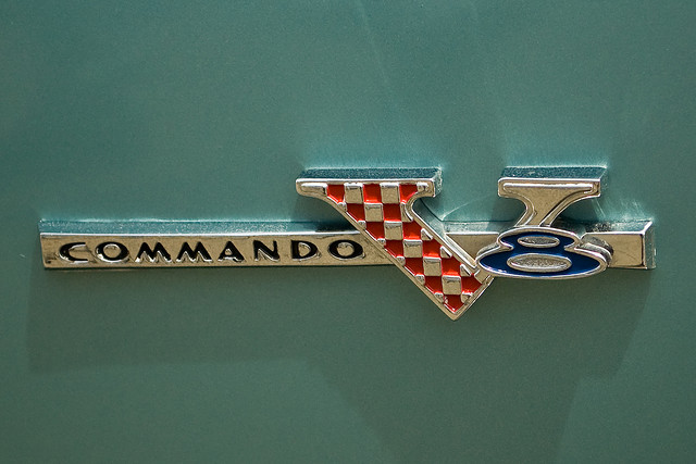

Hey Guys, a quick question. On a 1966 Satellite (or Belvedere), which motors got which badge on the fenders? I've identified four different ones, and besides the obvious 426 HEMI badge, I'm not sure what the 273, 318, 361, 383 got. I'm guessing that the 273 and 318 got the simple "V EIGHT" badge, the 361 got the "COMMANDO V8" badge and the 383 got the
"COMMANDO V8" badge, am I right?

IIRC 273 and 318 got "V-8", 361 and 383 got Commando V8"
(273-4 also got Commando V8 but was not available in Satellite)
That's in addition to the hood ornament which was blank for a six, "V8" for a 273, and then had the actual displacement for anything larger.

There is a "Post your 66/67 383-4 cars" thread where you can see both the 383-4 fender badge and the 361 badge are the same.

Not sure about that "Commando V8" you're talking about...
QUOTE]
This is the other I mentioned. Is it not from a 1966? (Edit: Never mind, I see that this is from a 1965. Too bad, I like it much better than the '66's.)
