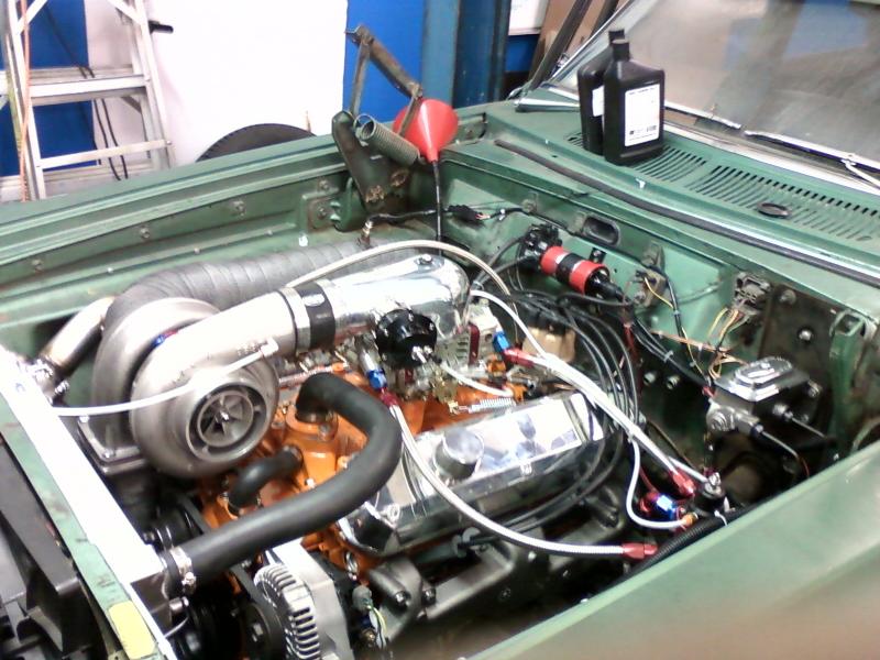

A 400 with twins would make an easy 1000. I'd use Trick/flows. Heck we make 800-825 with a stock 360 block/crank w/Eddys,.550" cam, stock exhaust manifolds at 18psi with a single 75mm. I'm sure there's more left. Just not sure how much is left in the stock cast crank. Turbo stuff is much more forgiving than N/A. Just keep it out of detonation, start conservative on the tune. To be honnest a new Gen 3 Hemi with a stock iron block, 2009 and up factory 5.7 heads, and a stock 6.1 crank will get you there. Just add rods, pistons and a cam, stock lifters and rockers.
