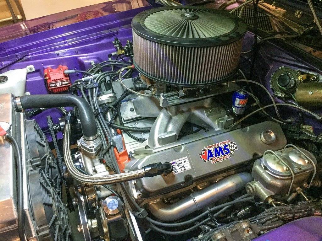

Here you go. Remove back bracket and drill hole accordingly. We added 1" to the bracket so it hung low enough for hoses to clear.
Perfect, thank you! Would you please pm me a contact number? I have a few more questions for you. Thanks, Bret
