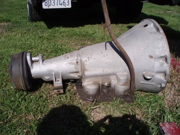

A motorhome (and some truck) 727 uses a different tailshaft than the ones for cars, trucks, and vans. This is one of the later...
This is a motorhome unit...
I see a LOT of motorhome transmissions for sale because guys buy them with the motorhome's engine, and plan to swap the tailshaft with one from a car/truck unit, and then find out those pieces are getting harder to find and the cost of the swap is more than just buying a rebuilt trans that's for their car.
