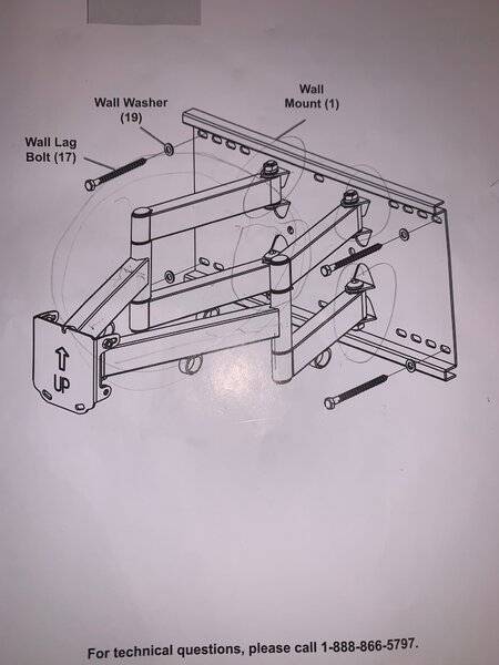

Here's the bracket I'm using.
https://www.harborfreight.com/37-in...tv-wall-mount-64357.html?_br_psugg_q=tv+mount
Decent quality, but the drawings in the manual are F'ed up.
I took Drafting and Design back in HS for two years, and these don't look right to me. The angles are off.
