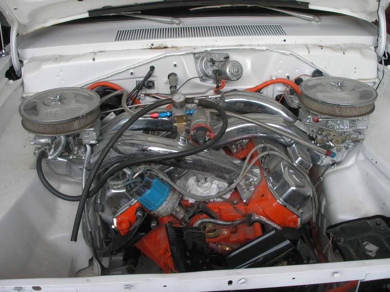

Long Rams on a 'warmed-up' 440 with a .509 cam.
'Traction Challenged' is the best description.
Big Daddy and Dennis Gage thought it was really neat.
