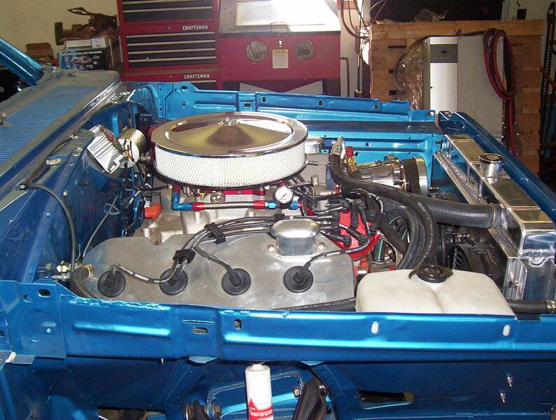

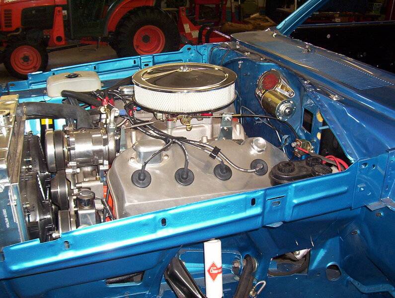

What do you have that those wires would not fit? Mine were perfect.
