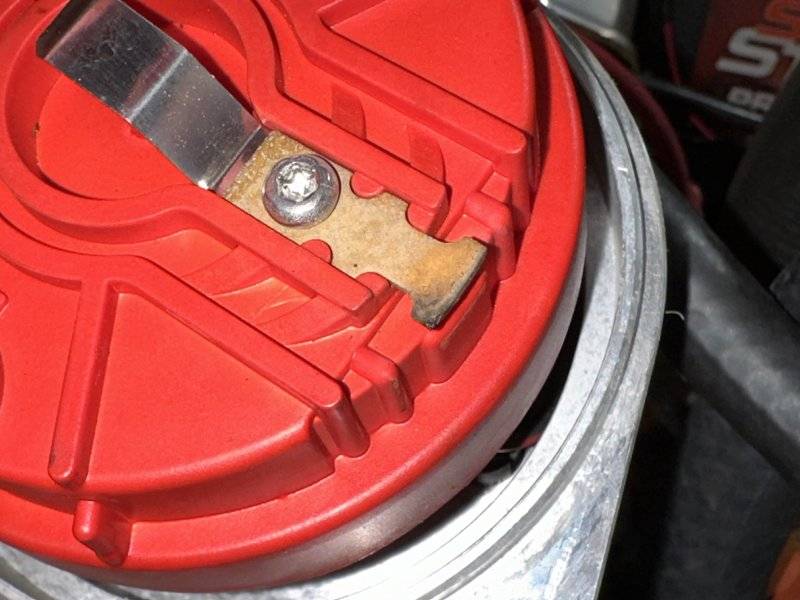

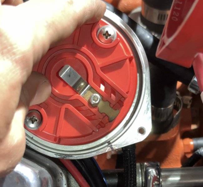

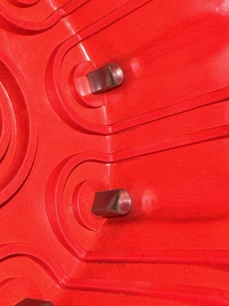

Hey guys, so I pulled the cap on my MSD distributor and the tang on the rotor is a little burnt up on one end, as are one side of all the posts in the cap. I am thinking an adjustable rotor/phasing the rotor would fix it but just wondering if it could be something else. Also, the rotor/shaft also seems to have a bit of play (not getting into the mechanical advance)

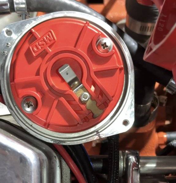

I wanted to check the rotor location when firing and I believe I did it correctly but tell me if I'm wrong. Base timing is set at 20 deg so I rotated the engine to 20deg on the balancer on the #1 cyl comp stroke. I then made a mark on the distributor body (black marker) to mark the location of the #1 cylinder post on the cap. The tang is at the far end of where the post on the cap would be and once the mechanical advance is added gets even further away.

The way you checked rotor phasing appears to be right.
Don't see anything that is burned up.
Static position of rotor tip & segment can be misleading. Has to line up when centri mech advances AND vac adv operates.

Yes it sounds like the rotor is phases a bit too far advanced but I the arc damage shown is not terrible.
Scrape (don't file) off the burnt stuff.

Are you having problems? I see nothing wrong with any of your photos.

IMO....The leading edge (direction of rotation) of the totor terminal's arc mark is normal. The trailing edge of the rotor terminal shows the result of the arc mark or burning is due to the physical spark as the rotor interrupts the spark voltage as the rotor moves to the next cylinder to be fired. This spplies to BOTH the rotor and the cap's terminal.....this is entirely normal and is to be expected......due to the higher voltage being switched....just a benefit of s MSD ignition system.....just my opinion of course...
