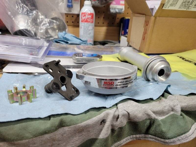

Rust was terrible in this distributor, MSD #8546, am replacing the reluctor wheel, pick-up, top bearing and seal. For someone that has done this, what did you have to do to get the reluctor wheel and locking pin installed on the head? File the wheel groove, freeze the head and heat the wheel, all of the above? I haven't messed it up , yet.

The reluctor, pickup and top bearing were rust, top bearing was well on its way to being gone. Anything that was bare steel, except the black oxide shaft and weights. My question was the trick to install the reluctor wheel and pin back onto the head.
Will look for answers elsewhere.
Thank you.

Just a dab of grease to hold the roll pin in the groove, slide the reluctor down till it engages the roll pin in the matching slot, then tap the reluctor home with a suitably sized deep socket & a small hammer....
Yeah, didn't use grease, the wheel just pushed the pin up the slot. I will try the freeze/heat thing tomorrow and see if I have better luck. Going to file the starting point just a touch to get it guided in. We'll see.
Well, this one isn't going as easy as grease it and knock it home. I have filed and messed around with it, finally lost the roll pin. Not a fan at this moment of MSD distributors, but it came with the car. None of the rusted parts, in my opinion, should ever have been rusty in the first place. Will call Holley in the morning and be open minded to their wisdom, and of course, more parts.
