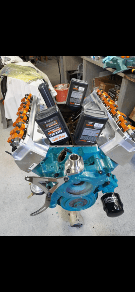

We rebuild my 440cui RB-Block and stroke them to 512 cui with 440 source kit .
after we using brand new 240 Trickflow heads for the upper part, and because I want change my ignition from revanator system to the MSD system I try to run the Programmable ignition Box from MSD and I buy the MSD pro billet distributor 8546(3) for this set up to exchange my old firecore “ fc1008B “ Race “ tall shaft distributor …
Problem : the MSD pro Billet distributor doesn’t fit in the distributor hole with the 240 Trick Flow heads + Aluminium spacer and original valve covers ….( my old Trickflow fit it)
Anyone run in to the same problem , and maybe fix it too, or have any idea to fix it ?
