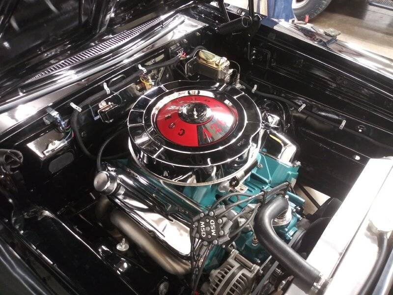

Looking for some pictures of plug wire installation on 440 msd Distributor cap. I would like pictures that shows where number 1 wire is. Thanks.

I know the firing order. What I'm looking for is how people have routed the plug wires to make them neat on the distributor cap
That isn't real easy, to many wires have to cross the cap.

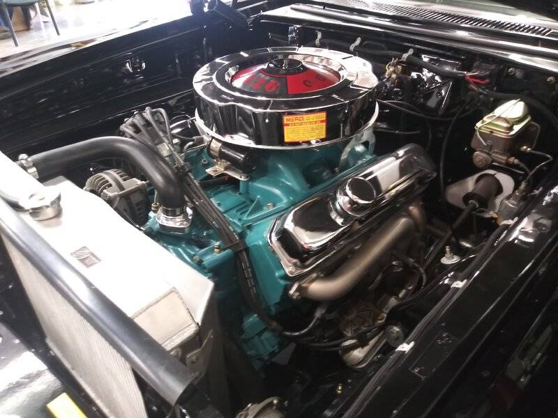

Here ya' go.

After looking at @OSDart 's picture I retract the above statement 4-5 o'clock position is correct. Also his routing looks great.
