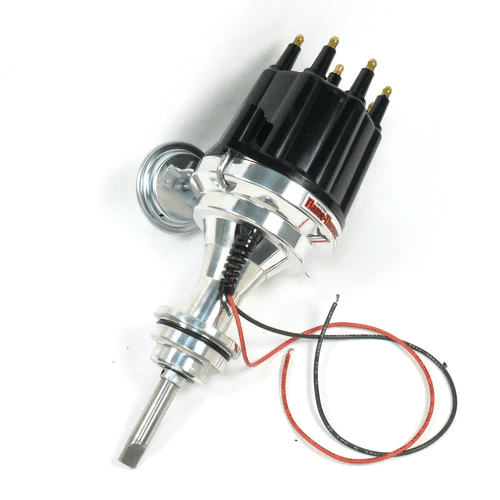

Well i found the actual shaft measurements. From the mounting surface to the end of the shaft is 3.5" on the BB engine distributors. Not the RB. This useful. The pertronix 7142710 has that length as does the MSD 8386. So even though both pertronix and MSD do not list and will not confirm when called, I rthink they work in the 361.
I'm about to find out because I've got the pertronix and am going to give it a shot
So I installed the Pertronix D7142710 distributor. Even though it is not compatible with a 361 according to Pertronx, it fit just fine. Along with the MSD high vibration Blaster 2 coil and MSD spark plug wires. Needed to solder a copper wire in the ballast resistor to keep the wiring original.
The entire job took about 2 hours.
It woke up the Chrysler. It's like a new car. The acceleration and speed is vastly improved. I had it up to 100 mph without any effort and it was still accelerating. Much smoother and I hope better gas mileage.
