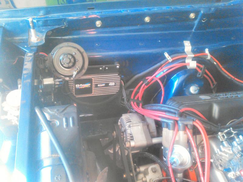

Not a good picture but this is where I have mine

Mine is in the same position as bobtile.
MSD recommended not in the glovebox. I know many have it there without problems.
I put mine where it is due to the wiring ran right by it so it made sense to me.
Good luck

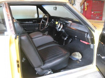

Mounted mine on the heater box

Don't use 3M. When it gets hot outside it will not hold. I put mine on that side also but used the mounts provided. I mounted it to the fire wall on the inside the car.
